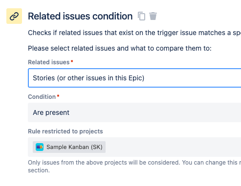

I would also recommend adding a condition after the check that the trigger issue was an Epic to ensure that the Epic has child issues.

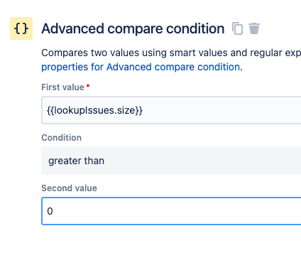

Or add a condition after the Lookup to ensure that the Lookup found issues:
