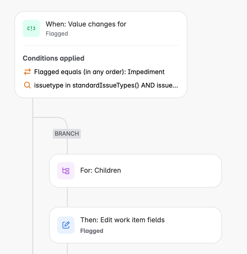

Hi @Glenn_Riley1,
The following rule should do the trick when you flag a parent work item as impediment:

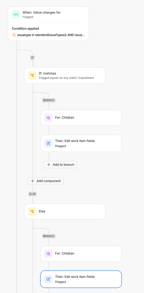

It is just to give you an idea of how to construct your rule and address the child issues. If you leave the condition on flagged equals Impediment out of the the trigger and replace it by an if ... else ... condition separately after the trigger, you can include both scenarios in a single rule for the child issues:
  • set the flagged field as impeded if that is what happened with the parent
  • or clear the field when you removed the flag from the parent
Hope this helps!

This is what the full rule could/should look like:
If the flag is being added back to the parent work item, there must be something out of place in your automation rule or something else must be kicking in.

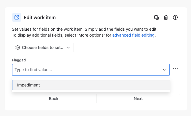

In the first Edit action, under the IF, you need to choose Flagged from Choose fields to set... and then select the value to which you want the field set; i.e.
In the second Edit action, under the ELSE, is where the flag gets cleared if it has been cleared on the parent. So again you need to select the Flagged field but leave the value selection blank to clear the field.
