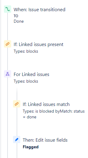

Alex Koxaras -Relational-
March 15, 2023 edited
@Patricia Francezi
As we discussed on slack, try the following rule :)
Patricia Francezi
March 15, 2023
Thanks @Alex Koxaras -Relational-
SSaved my day and removed my nightmares with this!!!!
5 votes

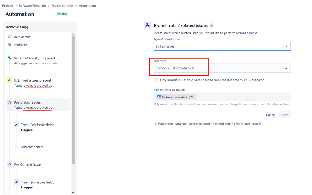

Fernando Eugênio da Silva
March 13, 2023
@Patricia Francezi
In fact, I believe you are missing including "is blocked by" in your "related conditions" and in your "branch".
This is because with the exception of "relates to", the other types of links have input and output vectors. blocks > is blocked by / causes > is caused by, etc.
Also, assuming my current issue is also flagged I've added a last branch to current Issue. See the rule:
Try to consider the values "blocks" and "is blocked by" in your branch and in your "related issues condition"
Let me know if it works for you
Patricia Francezi
March 13, 2023
Hi @Fernando Eugênio da Silva
THanks again, but the case is - I do need to look only to blocks links.
If I look to blocked by, Im transitioning the issue that has the flag itself to done, Its not the scenario.
I will listen transitions made in every issue, but the rule should be triggered only if that issue blocks something else.
