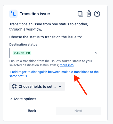

Create a separate transition to the Won't Do status that does not include the Validator.
On that new transition set the Condition for Hide from User.
That will make that specific transition available only to Workflows and the REST API. Automation Rules use the REST API so it will be available to the Automation Rule.
Then set the Automation Rule to use that specific transition.

In your screen cap, you pointed to "+ add regex to distinguish between multiple transitions to the same status ", which I am assuming I need to populate to call the correct transition.  Please confirm.  If that is the case, then I'm going to need some assistance with RegEx.
