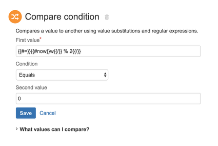

In order to do this, you will need to use Cron to run the rule every Monday at 9am and then use a condition to check that it is an even (or odd) week of the year.
Your trigger would like:
You condition (the first thing after the trigger) will look like:
What this is doing is:
The formulae is:
{{#=}}{{#now}}w{{/}} % 2{{/}}

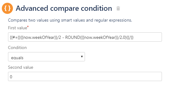

@Nick Menere it didn't work to me, however this comparison works fine:
It checks if the week number is even.
{{#=}}{{now.weekOfYear}}/2 - ROUND({{now.weekOfYear}}/2,0){{/}}

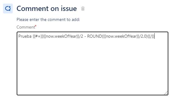

@Diego Quesada the simple way to validate math expressions is to print them in a comment. For this I recommend to create a rule for tests (that you execute manually or something like that) and add an action to add comment to the issue.
Put the expression above in the comment and run the rule and see the results.
The week number today is even (week #32), so the result should be zero.
If you need more help please share printscreen.
yes, now run the rule manually in an issue and see the results.
