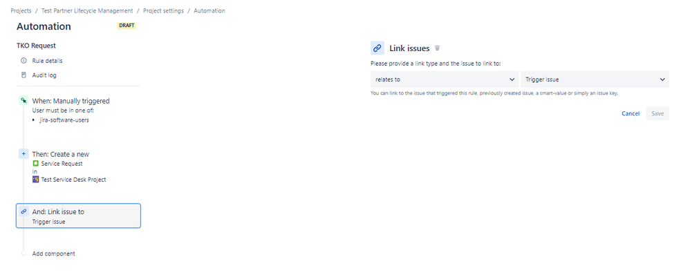

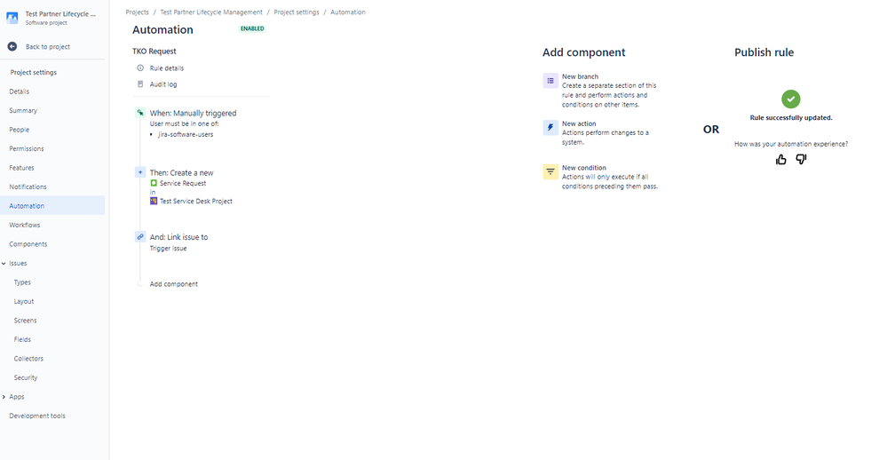

Hi there - looking for some guidance on how to set up a multi-step automation rule for a couple different scenarios in Jira Cloud. I tried to follow the automation guidelines in the Atlassian documentation but I can't seem to make it work.
1. When a ticket is created in a software project, upon manual trigger, a new ticket will be created in a service project AND the 2 tickets will be linked together using the "relates to" link type. (I have attached the 2 different ways I tried to accomplish this as screenshots)

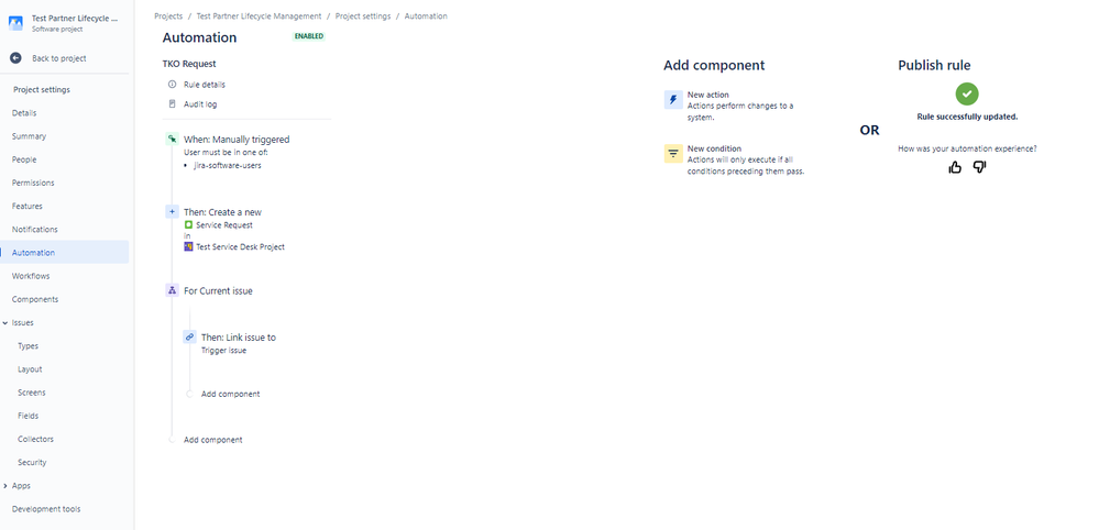

FYI that for the rule images you posted, one does what you describe and the other (with branch on Current Issue) seems to try to link to back to itself.

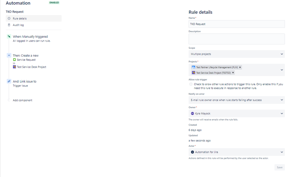

Thanks for replying. I thought my first screenshot, without the branch, should accomplish what I wanted too. However, it doesn't seem to do anything when the rule is run :(
For Scenario #2 - Do you happen to know the steps to make your suggestion work? Since I'm having trouble even linking newly auto created tickets, I don't think I'll be able to set the rules properly to execute these functions.

Can you please show the details of your rule's edit and link components, and and image of the audit log details showing what happens when the rule runs?
I know that "clone" cannot link issues in one automation step, but I thought the Issue Create action could do so.  Perhaps this rule also needs multi-project scope.

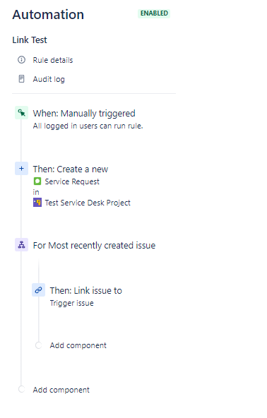

I actually think I figured it out - I had to add the action of create rule, then create a branch and select "most recently created" then add the action of Link Issue!
Still not sure the correct order of operations and which rules to apply for scenario #2 though - if anyone has suggestions!

Well done!  That is what I thought was happening with the missing branch to the created issue.
