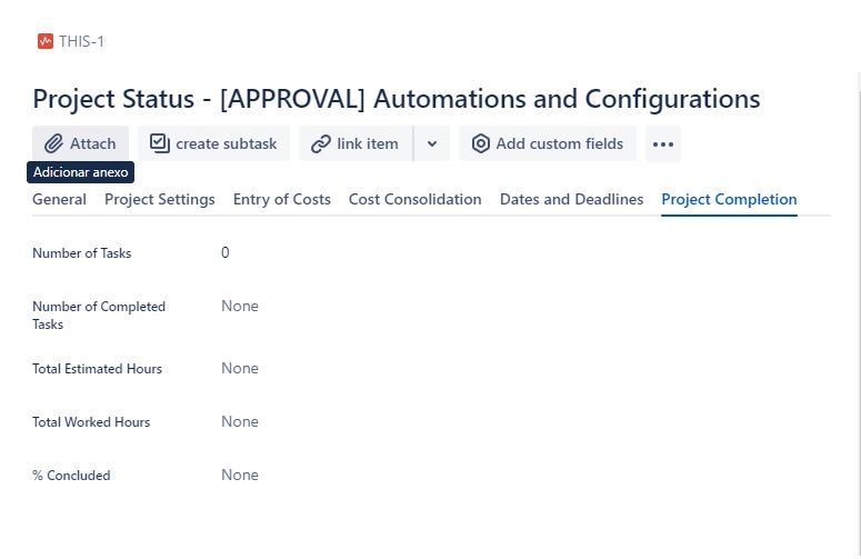

i'm trying to dev an automation to Decrement the field "Total Issues in Project" when i delete any issue. So, if i delete one issue, the field will receive field -1;
but it's not that simple. When the deletion of the issue trigger the automation, it's lose the reference because, technically, the issue that triggered the automation does not exist anymore on the project.
I take this screenshot to explain better:
The code on edit item field action: {{#=}}{{issue.customfield_10177}} - 1{{/}}

Well, let me explain my idea.
I have to know the exact number of tasks in a projet because i have a indicator that will return for me the % of the entire project conclusion.
To know this information, i've created first a new issue type called "Project Status", where i fill some fields manually and some with automations, in this line i've created 2 fields: "Number of tasks" and "Number of Concluded Tasks"
On the first moment, i've filled these fields with the {{lookupissues.size}} smart value, but i've noticed that smart value just return the maximum of 100 issues, so if i have a project with 101 or more issues, the return count will be 100 issues, ever.
So i've created a field "% Concluded" to return the diference between these fields and return the % of conclusion of entire project.
The first field, "Number of tasks" will receive (number of tasks + 1) in every task/subtask creation and (number of tasks - 1) in every task/subtask exclusion.
