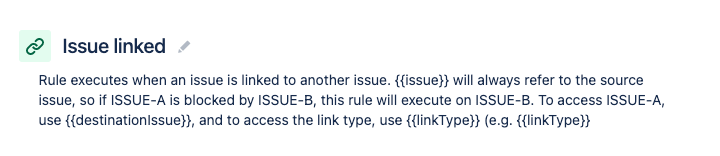

Hello @April_Delay
You need to look in more detail at the explanation for the Issue Linked trigger.
It depends on the link that you are creating between AA-1 and BB-1, and the "direction" of the link. Whichever issue in the pair gets the Outward Description of the link relationship is the one that will trigger the rule.
If you are in AA-1 and you create a link that says "blocks BB-1", then AA-1 is the issue that will trigger the rule. To link AA-1's parent to BB-1 you would have to use the smart value {{destinationIssue.key}}.
If you are in AA-1 and you create a link that says "is blocked by BB-1", then BB-1 is the issue that triggers the rule. To link AA-1's parent to BB-1 you would have to use the smart value {{issue.key}}.
Clarification -
{{destinationIssue.key}} or {{issue.key}} gets you the AA-1 issue. You need to add to that smart value to get the parent of AA-1.

Your problem is in understanding which issue, AA-1 or BB-1, is actually triggering the rule.
What type of link are you creating between AA-1 and BB-1?
Which one becomes the "source" issue? Refer to my Answer above about distinguishing which issue in the relationship is the source issue. The source is not always the one you are in when you create the link.
The source issue will be the issue that triggers the rule. That could be either the one you are in when you create the link, or the issue that you are linking to.
