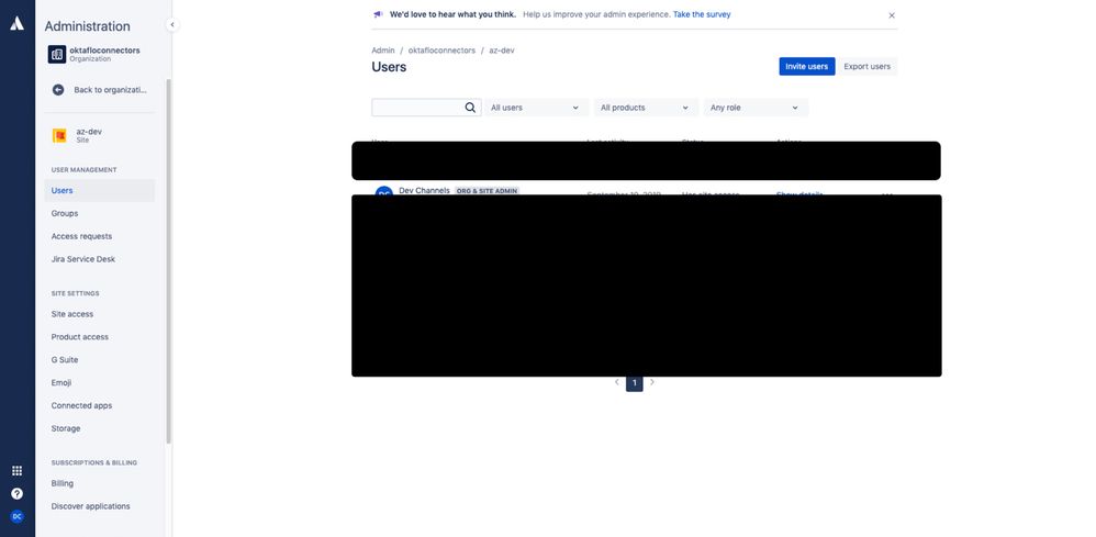

After step 1, when logged into my environment, I am unable to find the "Directory" or "User provisioning" tabs. Instead I directly land on user management:
Hi @Jared Praino ,
As the first step of the quoted documentation says, in order to see the Directory tab you need to select an organization:
Go to https://admin.atlassian.com/ and click your organization.
Now, it can be the case that you don't have any organization configured and that's why you are sent straight to the User Management of your instance instead. In this case, please review below links for more details on Organizations and how to setup one:
Let me know if this helps.
Cheers,
Dario

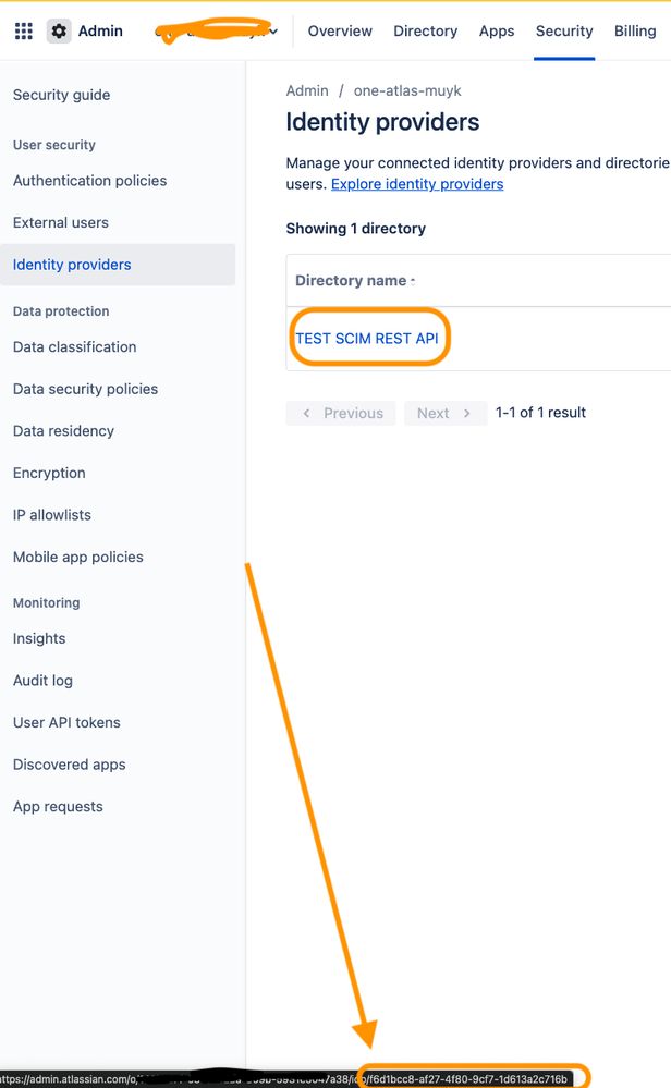

Hi @Ernest Micklei ,
Please notice that the previous question was correctly replied since it was explicitly asking for how to get to Directory > User Provisioning tabs in admin.atlassian.com:
After step 1, when logged into my environment, I am unable to find the "Directory" or "User provisioning" tabs. Instead I directly land on user management.
Indeed, the Directory ID is the one you actually create from Directory > User Provisioning tab in admin.atlassian.com. See below screenshots for details:
Once the directory has been created. The Direcrory ID is still visible under Directory > User Provisioning tab in admin.atlassian.com:

Your could try following URL replacing OrgID with your Organization ID:
https://admin.atlassian.com/gateway/api/adminhub/external-directory/manage-directory?orgId=OrgID
