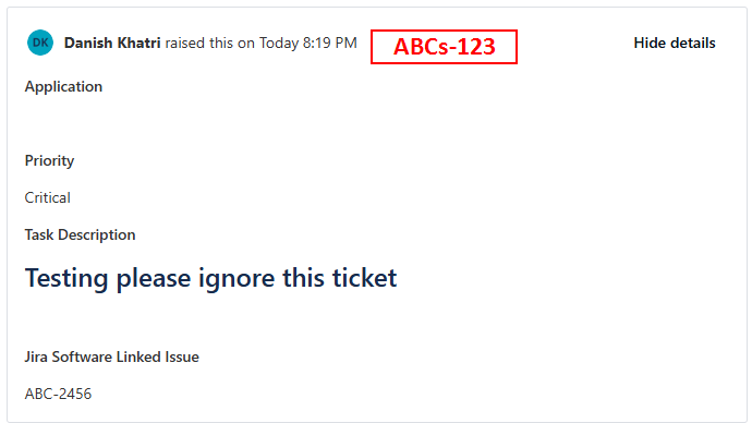

When a customer creates a ticket in Jira Service Desk, a clone gets created in the Jira software project which basically help us to communicate and provide updates to customer, now what i am trying to achieve is to show my Jira software project key in the customer service desk view using label.
For e.g.
ABCs-123 (test ticket) --> created by customer using Jira service desk
ABC-2456 (test ticket) --> clone created in my Jira software project
Now in the customer service desk view they should be able to see the clone ticket no i.e., ABC-2456 using label field.
Issue - When the rule is run it shows successfully run but label field is somehow not getting updated, How can i achieve this?
Note: the value you see below is manually updated and not using automation

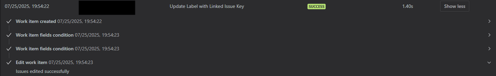

Sure but there is nothing much in the audit log other than it says "executed successfully".

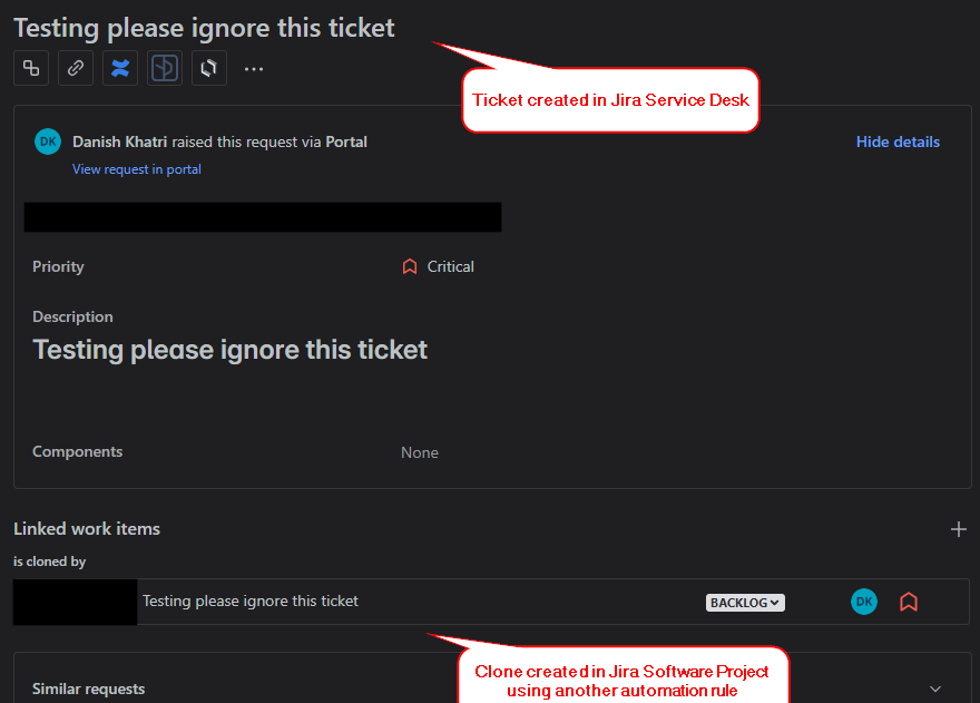

Hello @danish.khatri
I reviewed your last reply (where you included images) again and I see that in the image you added the note "Clone created in Jira Software Project using another automation rule".
That would be part of your problem then.
Your rule to set the label to the linked issue key is triggered by creation of the JSM issue. It is highly probably that the rule that creates the Clone issue has not completed before this rule to set the label has been triggered. So there is no linked issue to retrieve yet.

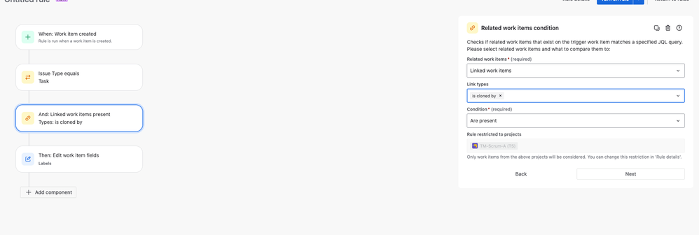

You could check that by adding a condition to this rule prior to trying to set the label
But that will only edit the label if, by chance, the automation rule that creates the clone issue has completed.
In the scenarios where the clone process has not completed you would need a separate rule to get the label updated.
I recommend instead that you amend the automation rule that is creating the clone issue so that it will also update the labels of the JSM issue. This separate rule to update the JSM issue labels would then be unnecessary.
If you show us that other rule we can advise you on how to amend it.

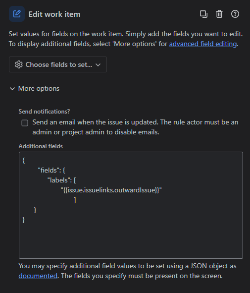

For the JSON expression you show, there are a couple of things preventing the update...
Assuming the created work item has one-and-only-one outward link, please try this expression in the JSON:
{{issue.issuelinks.outwardIssue.key.first}}
And as a safety check to prevent problems with other work item creations triggering this rule, you may want to add a smart value condition to confirm that key is in your software project. This could be done with a text comparison, or if you increase the rule scope, with a JQL or other condition on the actual work item.
Bill
Thanks @Bill Sheboy
I'll try this out.
I even tried implementing the following but still it didn't update anything.
{{issue.issuelinks.outwardIssue.key}}

As recommended, i used REST API to get the work item and then found the smart value to be "inward" for the link issue. I updated my JSON to the following but it still didn't updated the labels with key of linked Issue (This issue is from other project)
{{issue.issuelinks.inwardIssue.key.first}}Then i thought it might be wrong JSON update command i would be using hence i updated it to the following and still it didn't updated the label with key of linked Issue (This issue is from other project)
"update": {
"labels": [
"add": "{{issue.issuelinks.inwardIssue.key.first}}"

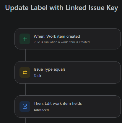

Please post an image of your current, complete rule in a single image, an image of the edit work item action, and of the audit log details. Those may help explain what you are seeing.
And...if your rule is using the Work Item Created trigger, this could be a timing issue: that trigger has a problem where the rule can start before all data is available. Seeing your rule image will confirm if this is the case.
If so, the next step would be to add the Re-fetch Work Item Data action immediately after the trigger (before other steps) and then re-test.
