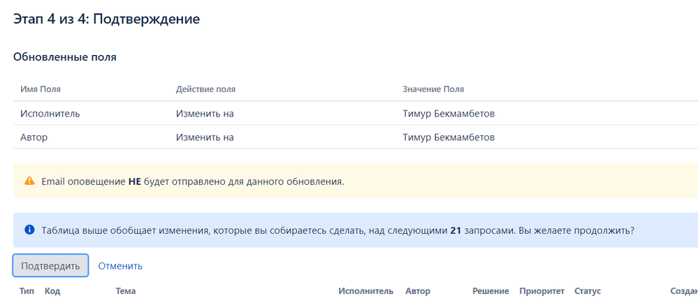

I have an example that the notification in the Jira Mobile application is different from the desktop Scheme Notification in the project.
I changed the assignee in the issues, but an issues update notification was send. The event Issue Update in Scheme Notification is empty.
Why we receive a notification in the mobile application?

I was wondering if you can try just updating a field in an issue (like, updating a description), rather than changing the assignee.
When you change the assignee field, I think what you are firing is actually an issue assigned event (rather than an issue updated). OK, you are effectively updating an issue, but in this is case is a more specific event. And your notification scheme have recipients set to issue assigned events.
Thus, for me it makes sense to receive notifications if you change assignees. I would try updating a normal field (like the description field) and check if you receive a notification. In this case, I would expect no notifications to be sent.
A different problem might be occurring though (and I'm curious about it). Given that you are suppose to receive notifications because you changed the assignee (and you have notifications scheme set for this event), you should receive notifications in the mobile app, via email and in the notifications bell inside Jira.
We are using Jira Server v8.7.1 :)
Notifications in application were about updates issues, but not about changes of assignee.
Maybe it's because of push-notifications that were sent in application?
