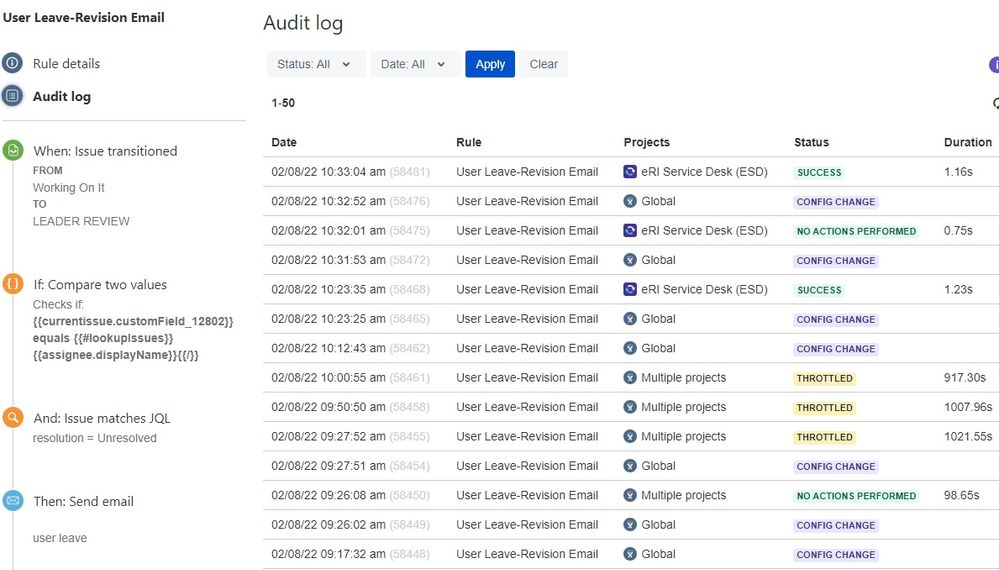

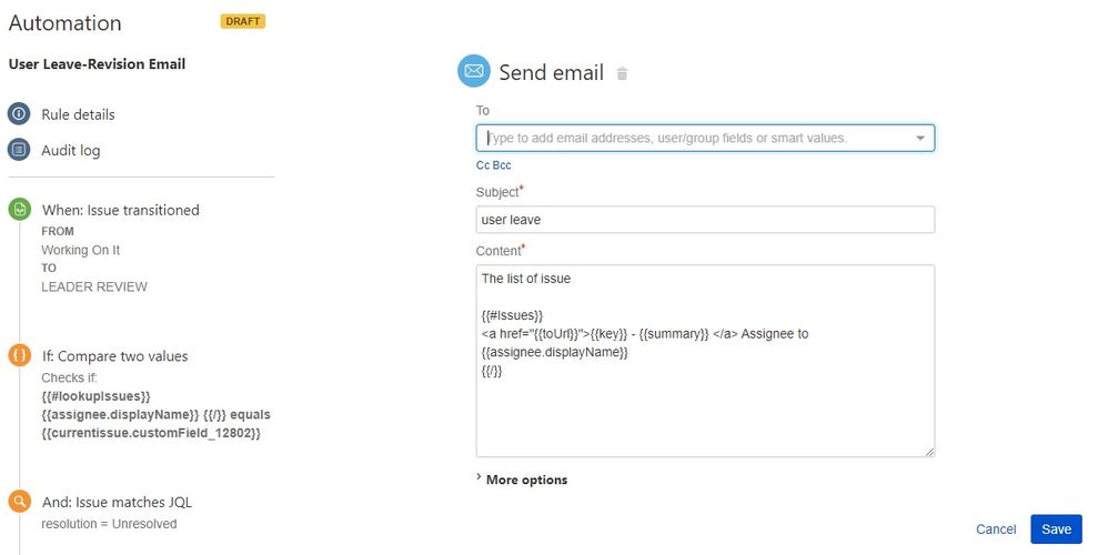

I do this but it just returns one issue while I searched it has to return 5 issues in the email.
@CRS123456 your automation seems to be ok.
Did you check just your JQL, does it return all the issues you want?
Does your issue is in the JQL step or the email step?
Can you share a screenshot of the email step too?
i think the email is fine, also, you say you get 1 issue in the email, i think if the problem was the email you would have get nothing...

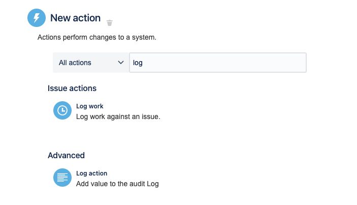

try to add "log" step and log your JQL result, than see what the logs print
Hi @CRS123456
It's ok, you can add "Log" action anywhere you want in the automation process.
Simply click to add new action and choose "Log Action" (not "Log work") :)
@Nir HaimovI found it and put it in after the IF.
It wants some value. is it right? I put {{now}}.
I saw some problems like mine!! where can I see the results?

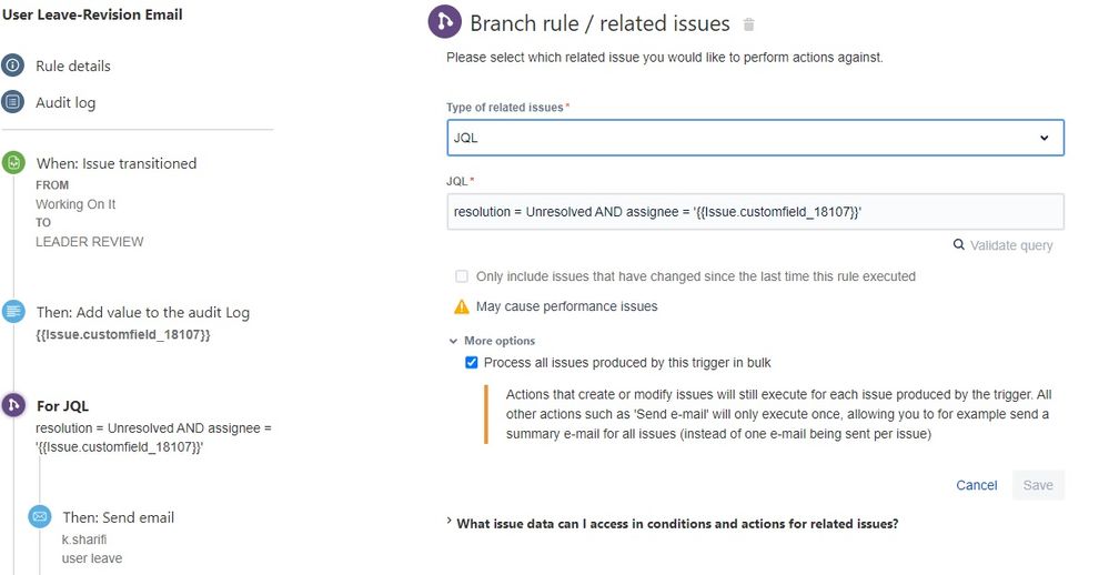

This can't be exactly perform as you whish in Jira Server (in cloud they have this feature).
What you can do int Server is the following
But this will send you 1 email for each issues found in the JQL (and not 1 emails with all issues in it)
So i think that eventually it will better to do this with ScriptRunner
Hi @CRS123456 and @Nir Haimov
For the server/data center version of automation rules, you can use the bulk-processing option with that branch, and so send only one email: https://confluence.atlassian.com/automation/run-a-rule-against-issues-in-bulk-993924653.html

@Nir HaimovI think scheduled is not bad such as every day at 10 am if the status is Leader Review.
but when I put unresolved condition in the scheduled it returns 4900 issues and throttled so this is not right.
@Nir Haimovwhen I looked at the audit log I saw config change was in the global but when the rule was run, the project was ESD while I want this rule runs in all projects.
Some work is not right and I don't know where!!!

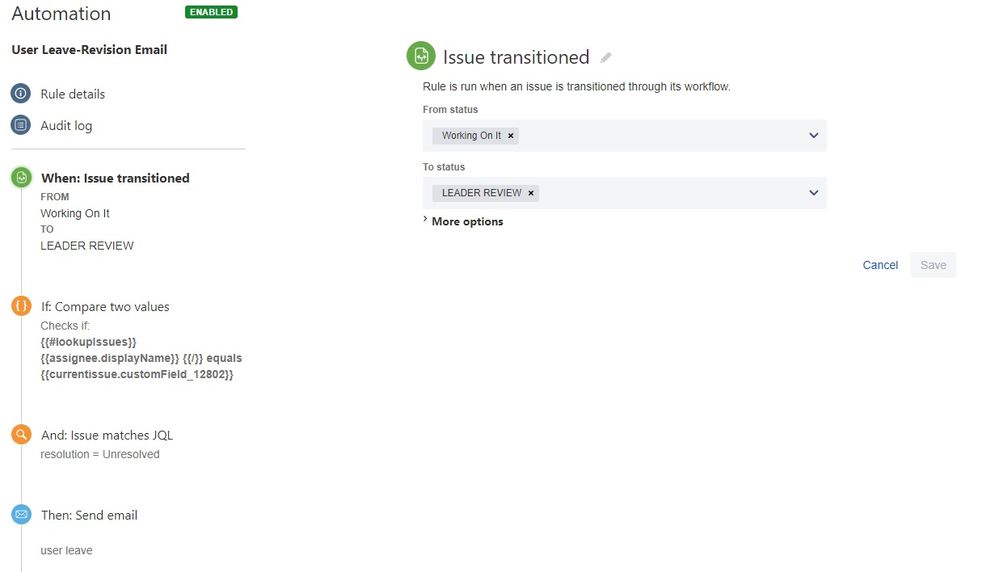

Hi @CRS123456 check in your "rule details" (top left) make sure this rule configured for all projects and not specific project
@Nir Haimov Yes It's on all projects.
I'm trying a different way but it still shows me one issue in the email.
I can't understand!!

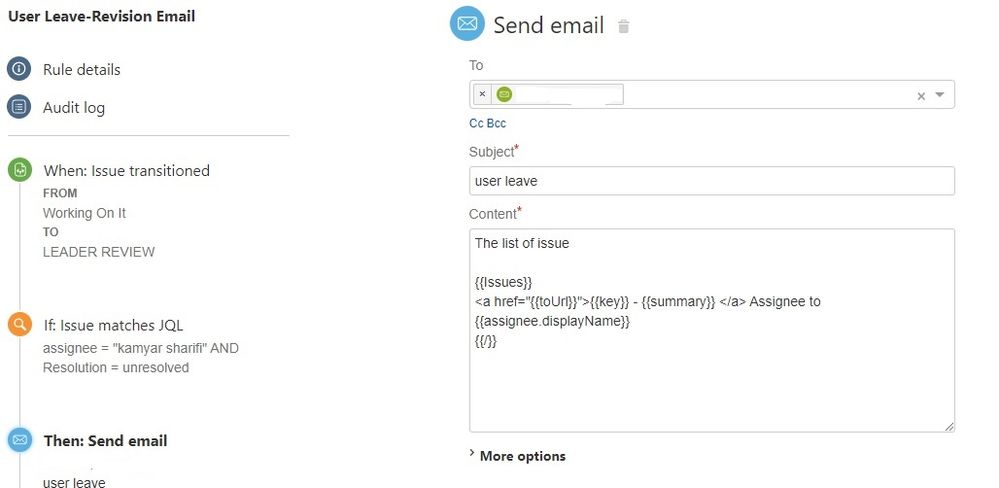

For when I use scheduled and gave it a time and for condition, I wrote resolution and assignee to my name as a result the email was sent right.
Now I have to change the assignee to the Full Name field value. The hard part is here!!

I believe that @Nir Haimov already asked if this was a user-picker field or text field. If it is a user-picker, it should be simple to just assign the person. If it is a text field, containing the name, you will need a way to determine the user's accountId from the name, such as by calling the REST API.
@Bill SheboyThank you for helping me.
The Full Name field is a text field and every time value is different so I want to compare the Full Name value and assignee of all issues and returns the issues in the email.
If necessary I can change the Full Name to a user picker if it works easier because I don't know about REST API.
one more thing, I read somewhere I can use smart value in the JQL but in mine, it didn't work. does it have a special rule? Or maybe I used it in the wrong place!!
note: I changed Full Name field to a user picker because It doesn't anybody write wrong. Also, it doesn't matter for me if had a schedule or not and when I start automation with issue transitioned all commands run in in one project whereas I want the result in all issues.
