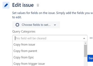

Hi John, I've had a decent amount of experience with Automation in Jira so I'm pretty familiar with the out-of-the-box functionality. In the Edit Issue action, you're able to edit field values - you can either copy values in certain ways (see below) or can set the field to a custom value.
What I'm looking for doesn't seem to be available out of the box, so I assume I would have to use the 'Additional Fields' section to be able to add values from one field to another, without having to copy the whole field which would wipe the original values

Instead of choosing the "This field will be cleared" option, click the 3 dots to the right and choose Copy from Current Issue.
Callum Carlile July 13, 2020
Thanks @John Funk , it was this Copy From section where I found the answer, I was looking for the 'Add to existing values' Checkbox. It's working fine for me, thank you for your help!
