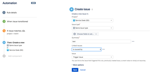

- Create the following rule, choosing which projects that the issue should be transitioned to trigger the automation and link the issue to each other, so you will be able to edit the status when one is updated:

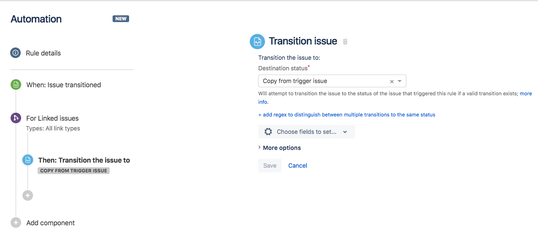

- Create another rule that will update the status when the other issue is transitioned:

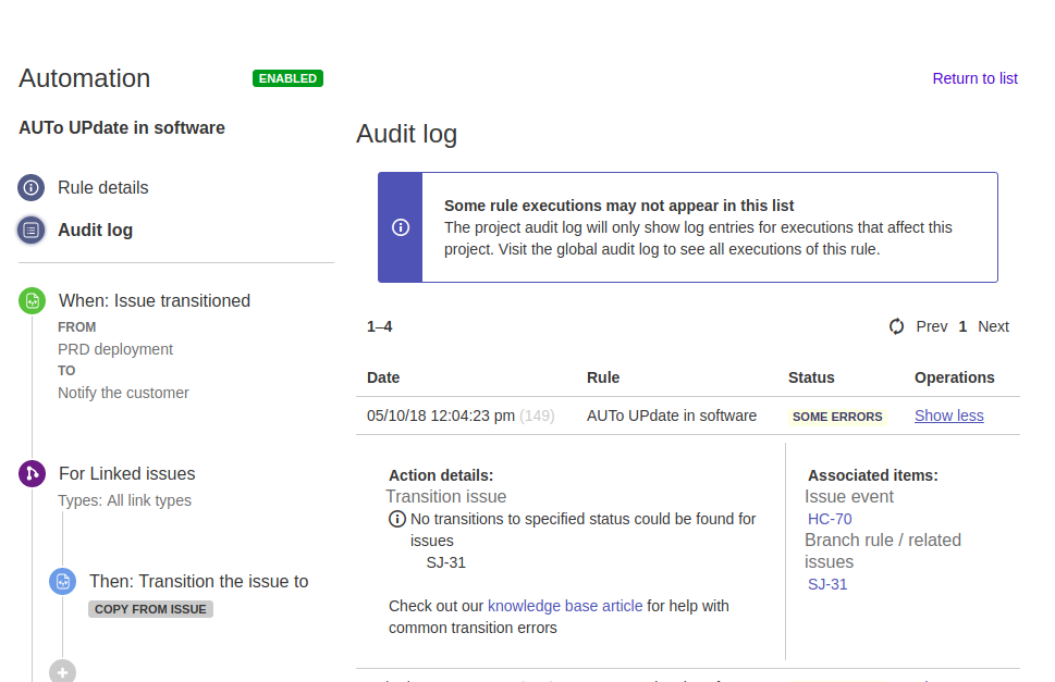

In both the project same workflow is configured, when i check the logs i'm getting an error stating no transition to the specified status.Screenshot from 2018-10-05 13-39-48.png
