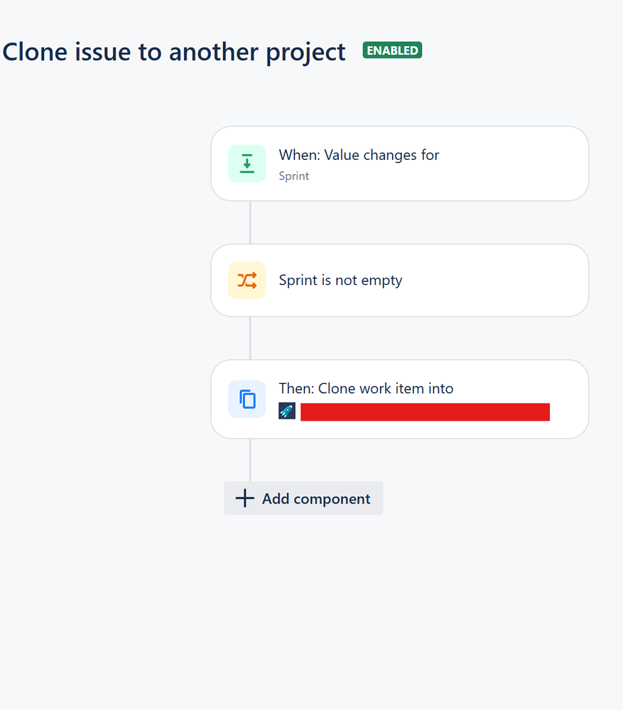

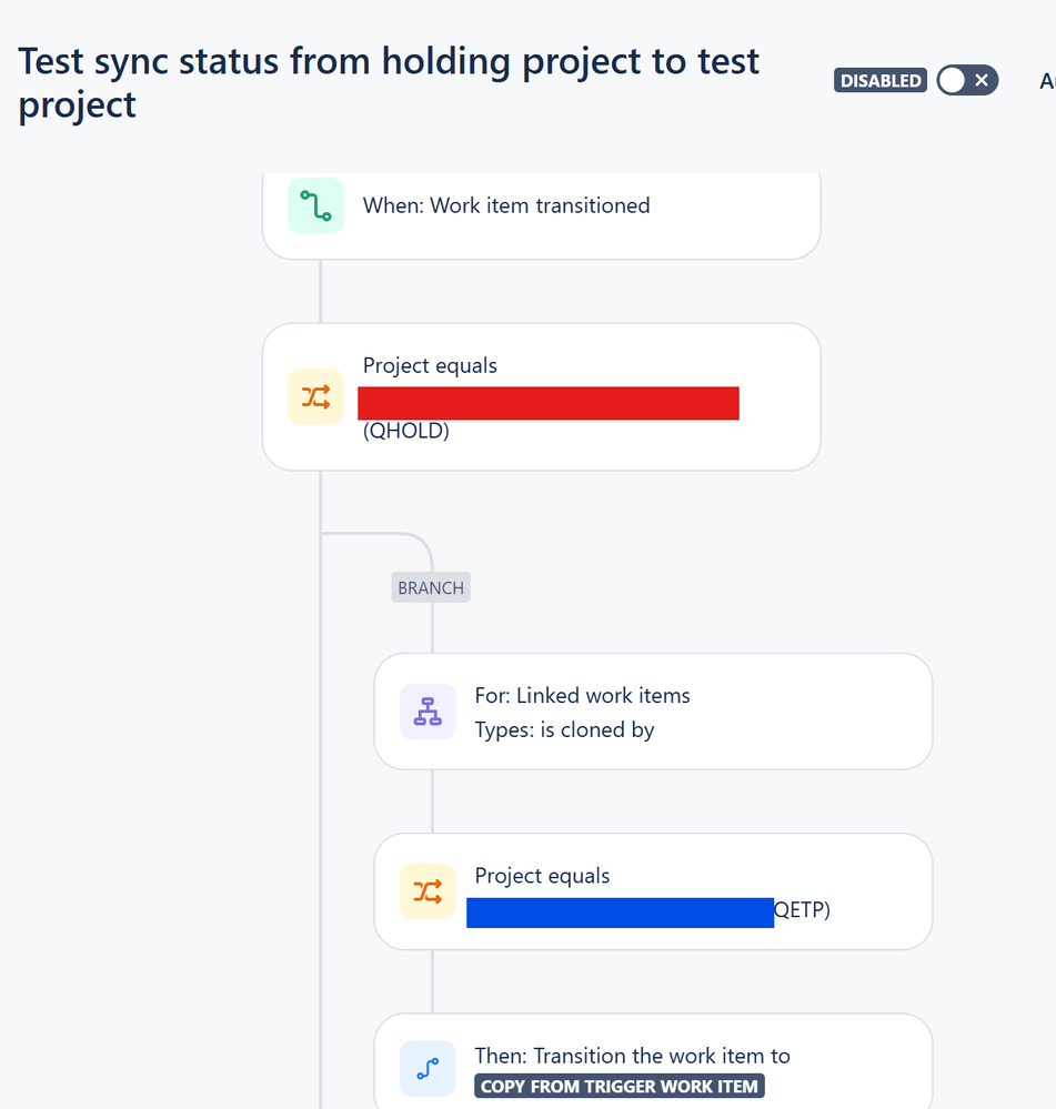

I still really new to setting up rules in jira automation. I want to be able to automatically clone issues from the active sprint in Project A (blue box) to the one in Project B (red box). And then be able to sync the status in Project B to reflect back to Project A issue status only in the active sprint (not the backlog).

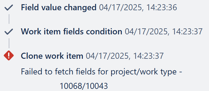

So far, I tried running the cloning issue rule but I gave me an error message. (see below)
Can someone please let me know what is wrong with the rules and if I set up anything incorrectly?
Clone issue rule:
Error message after running Clone rule:
Sync status:

As to why you might be getting the above error, that is likely has something to do with the project Types you are using. Can you tell us the project Type for each project? Get that information by going to the View All Projects page under the Projects menu. Find each project in the list. Tell us what it says for each project in the Type column.

Team managed projects are designed to allow for project-specific customizations that are isolated to that one project without affecting other projects, whereas Company Managed projects are designed to use entities that are defined globally and are shareable between projects.
The entities in Team Managed projects, like Issue Types, custom fields, and Workflow Statuses, may have the same names as entities used in Company Managed projects, but in the backend they are considered entirely separate entities.
For instance each issue type has both a name (i.e. Story) and a unique identifier in the database (i.e.10100). All Company Managed projects that have an issue type named Story are using the same issue type entity; the one with the ID = 10100. However the Story issue type in each Team Managed project has its own unique ID that is different from the one used by Company Managed projects.
In an Automation rule, if you use try to use the Clone Issue action to clone an issue between a Company Managed project and a Team Managed project (or between two TM) projects, you can't use the "Same issue type" option in that action. That option is not using the name of the issue type but rather its unique numeric ID to determine which type of issue you want to create. And, as I said, the unique IDs are going to be different in this case.
You would first need to change the Clone action to explicitly specify the type of issue you want to create in the destination project.
You will run into a similar problem with trying to synchronize the Status values. Even though the projects use Status values with the same name, the IDs in the backend are different. You won't be able to use the COPY FROM TRIGGER ISSUE option to update the Status of the source issues. To try to synchronize Status changes from the destination project back to the source project you would have to build logic into your rule to map the statuses between the projects.

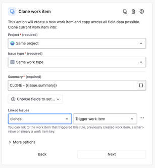

Thank you so much Trudy! I had tested it with 2 company managed projects and the cloning rule works now! It will add CLONE in the issue name.
However, the statuses are still not syncing. I have a feeling it's because the issues are not linked to each other. Is there any way to do that?

When you use the Clone action in a rule by default it doesn't create the Link between the source and destination issue.
In the Clone action you have to explicitly add that by choosing to set the Linked Issues field.
