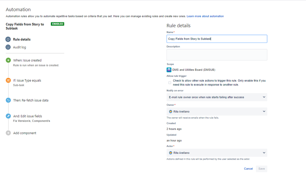

Hi Guys,
How do I copy field values from a parent(Story) to child(subtask) ?  So far the only thing that prefills is the link which I have set as child off.... but the fix versions and components are not being automatically copied from the parent(story) issue. below is my automation rule.

Hi @Rita Arellano
First of all:
Is there any info in the audit log? Could you please share a screenshot of its output?
Furthermore:
Is the issue that is created of issue type sub-task or a custom standard issue type called „sub-task“?
I‘m asking this because of the linking action. A subtask issue type is automatically a child of a standard issue type.
And furthermore:
Even if the linking happens: Does it work correctly? From my perspective it seems that the created issue is linking to itself. (trigger issue is the same issue you are editing as there hasn‘t been any change of issue scope).
Best
Stefan

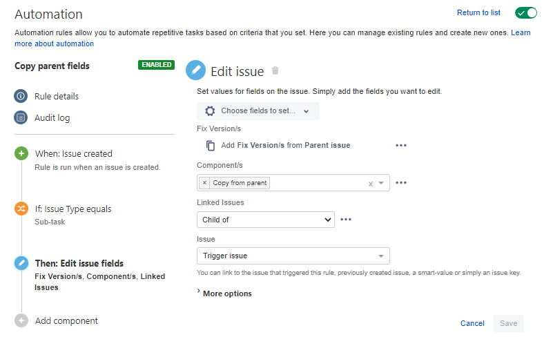

Rita Arellano
October 2, 2022
Hi Stefan,
Actually I figured it out. See below:

Ansar Thennaden
November 12, 2022
@Rita Arellano  Can you please share what you had on the 'Edit Issue Fields' stage please
