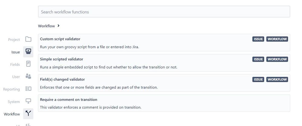

As you have mentioned, I think it is necessary to install the Utilities Suite (JSU Automation Suite for Jira Workflows - Server Version) to change a field to mandatory during the workflow. But that Suite of Utilities is not free.
Is it possible to use a "Custom script validator" or "Simple scripted validator" to make a custom field mandatory during the workflow?
Thank you
I have seen this:

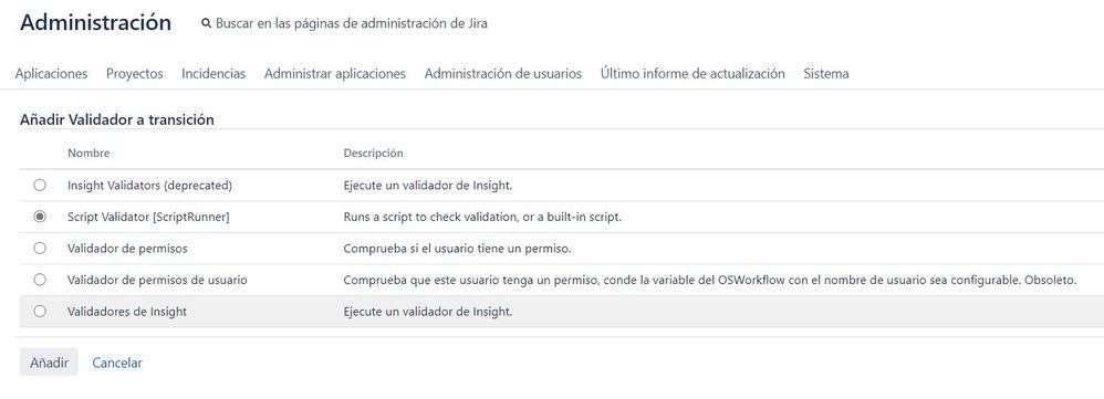

I have already created the transition screen, but when I go to create the validation to change the field to mandatory, no valid option appears.

Thank you very much for your answer.
I'm doing it, but it returns the following error:
How can I solve it? Thank
