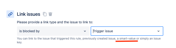

Hello @Inna S
You can use a smart value as the issue to which to link, per the help text in that action

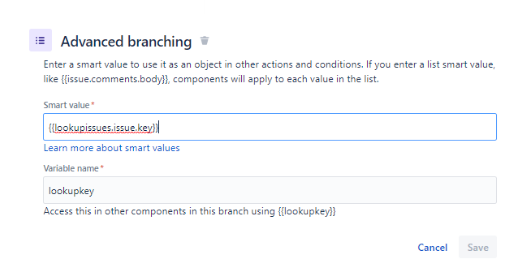

2. The Lookup Issue Action. Note that action is limited to retrieving 100 issues. You can iterate through the results set using an Advanced Branch option:
