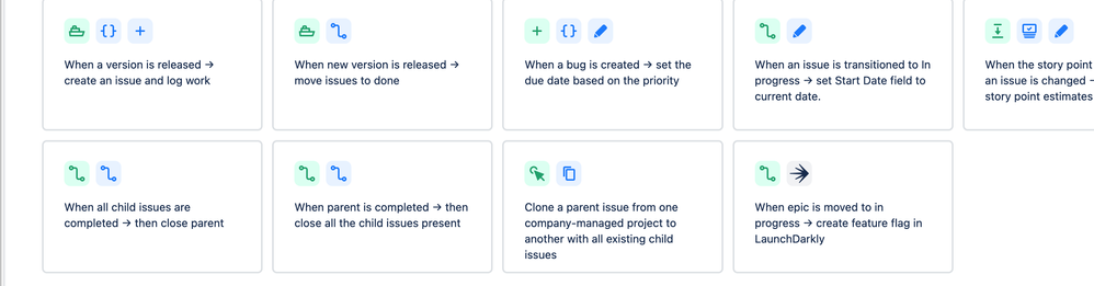

Hello @Yousuf Al Rawahi
You can use the premade template by Atlassian:
You would be interested in "When parent is completed then close all the child issues present".

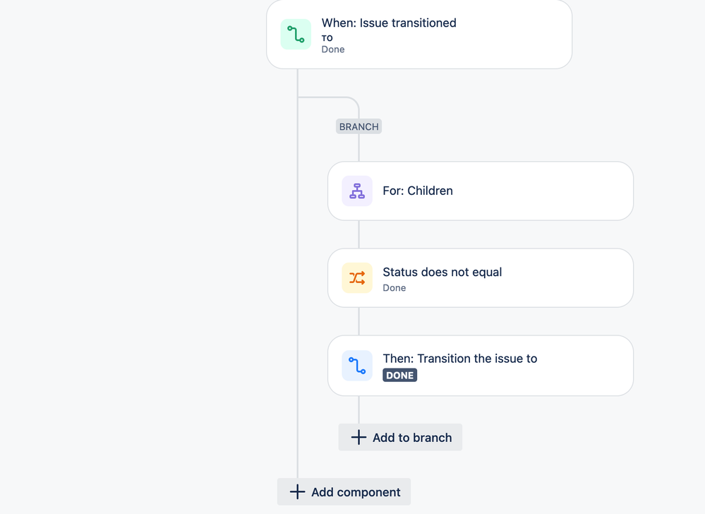

This is how the automation rule looks like:
For the triggers (which is the green icon), you can adjust the status to be different. Also, this can be done to the child issues when you adjust the status (blue icon) field.
