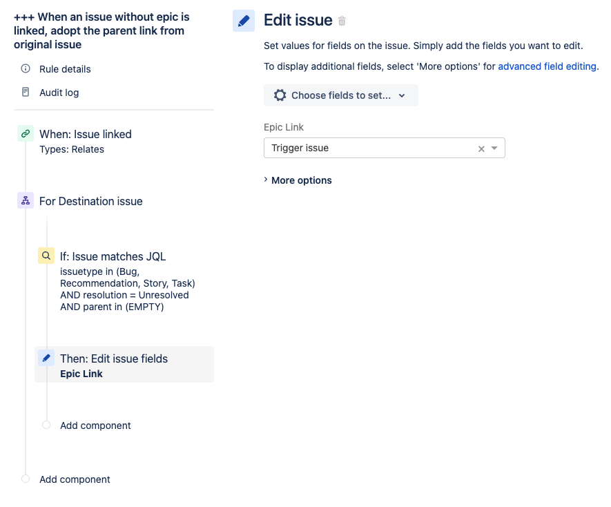

In order to get around this, I've created an automation rule to look for the parent/epic of the linked issue and apply it to the bug:
When an issue without epic is linked, adopt the parent link from original issue.png
It works great when the link type is "Relates to", but when a bug is linked to an issue as "Blocks" it reverses the direction of the link relationship so that the Bug is the Current Issue instead of the Destination Issue. I can't seem to come up with an automation rule that pulls the parent from the Current issue instead, and I've tried everything I can think of. Jira offers no way to use a smart value to find the issue link. Also, there is something funky with the way next-gen projects use parent vs epic links, and so attempts to do the same rule using the Current Issue as the branch criteria fails with this error: "No fields or field values to edit for issues (could be due to some field values not existing in a given project):"
As a stop-gap measure I had to create a rule that copies all of the issue links from the destination issue over to the bug as the issue link type "Related to", which then runs the original rule and applies the epic link, but it's messy and could easily cause the wrong epic to be linked. I've also considered

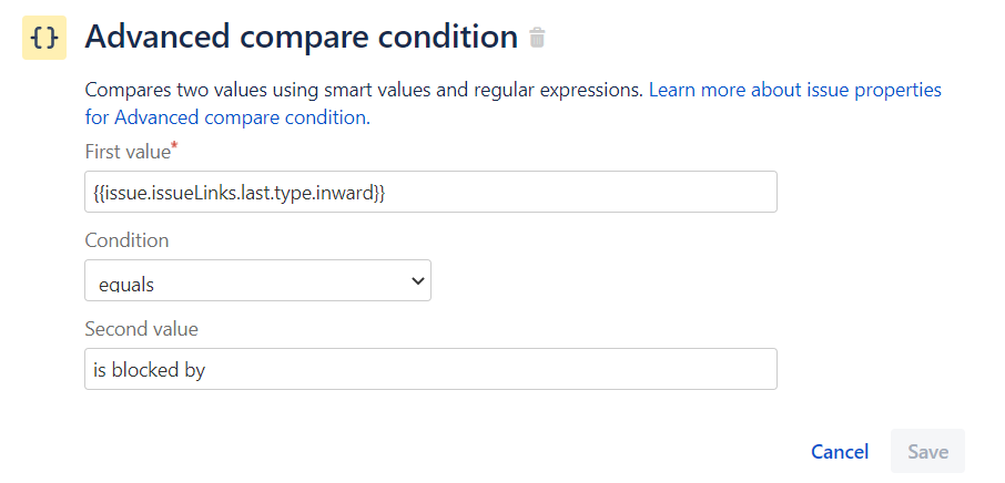

Bill Sheboy
May 21, 2021
Oops... My bad: you cannot check that in the trigger as the "blocks" and "is blocked by" are tested at once.  Instead you would add an advanced compare condition for the last added link after a generic linked trigger.
By the way, the method to find the names of the smart values which are not listed on the documentation pages is described here:
