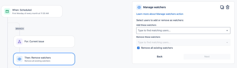

So I`ve decided to follow a two step approach.
1. step/rule (the easy rule)
My scheduled JQL "watcher in inactiveUsers() AND watchers = 1" gives me list of issues where I can simply use the "remove all existing watchers" flag.
This rule works fine. At the beginning it runs every month but in future it might be enough the run it once per quarter.

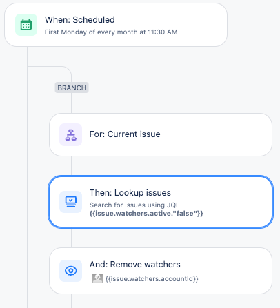

2. step/rule (for issues with more then 1 watcher)
My scheduled JQL here is "watcher in inactiveUsers() AND watchers > 1".
My lookup checks for issues where the watchers.active value is set to "false". Then I use a smart value to remove the users as watchers.
The rule removes watchers without errors but it does not limit the list of watchers to the inactive users = it removes also active users.

I`ve also tried it with this lookup:
and with changing the content within "Remove watchers", but then it generates different error messages depending on my test changes. E.g.
- Field '5e9d82c24e1a4b0c136ea646' does not exist or you do not have permission to view it
- Error in the JQL Query: A field name cannot be empty.
Maybe you have a suggestion how to proceed with my second rule/approach?
Thank you in advanced!
