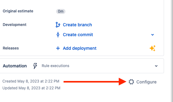

Did you remove it from the Issue Layout?
From an issue where it is visible click the Configure button below the panels on the right.
That will take you to the Issue Layout configuration for that type of issue.
If the field is available in the Field Configuration for the issue then it can be placed on the screen from the Issue Layout, even if it is not in the Edit or View Operations screens.
This is one of the changes of the "new issue view". The display is not solely based on the Edit and View Operations screens.
From the Layout screen you can drag a field from the display in the center and drop it in the panel space on the right to remove it from the screen.
