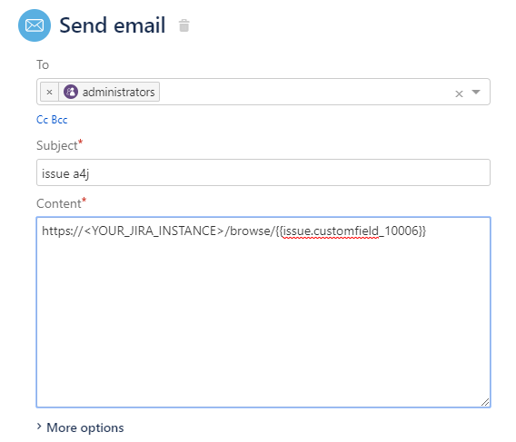

It seems that the best solution for your scenario is using this structure below into the email action:
https://<YOUR_JIRA_INSTANCE>/browse/{{issue.customfield_10006}}
With this code above you'll add the value of the custom field into the end of your URL.
Can you give a try and let me know how it goes?

Thank you!
Your advice helped me. It's work. But not the way I would follow )
Replace function still not work as well (
