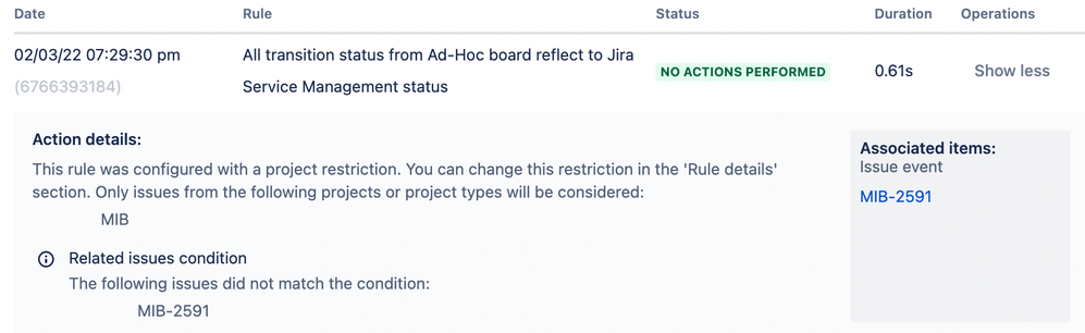

But, this rule doesn't work at all . When I update the status from MIB board, it only happens on MIB board.
here is the log:
Can someone help me? any ideas would be very helpful. Thanks!

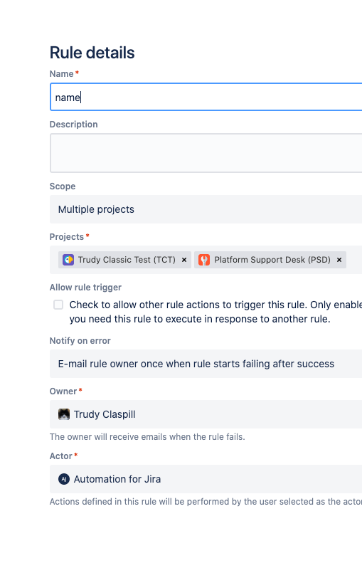

Does the issue MIB-2591 have a "blocks" link to an issue in the BSM project?
If so, did you create this rule in the MIB project or as a Global Automation?
I believe in order to be able to reference the two projects you will need to create a Global Automation and set the scope to both projects. Then you may need to make the rule more complex to ensure it is triggered by only the status changes in the MIB project, and changes only the linked issues that are in the BSM project.

Hi, @Trudy Claspill it works! I follow your example above and now it works. Thanks for giving me help! :D
So basically if I want to update on one side and I want to that reflect in the other board as well, I need to make the rule a global rule, right?
Trudy Claspill
March 2, 2022
Right, you've got it.

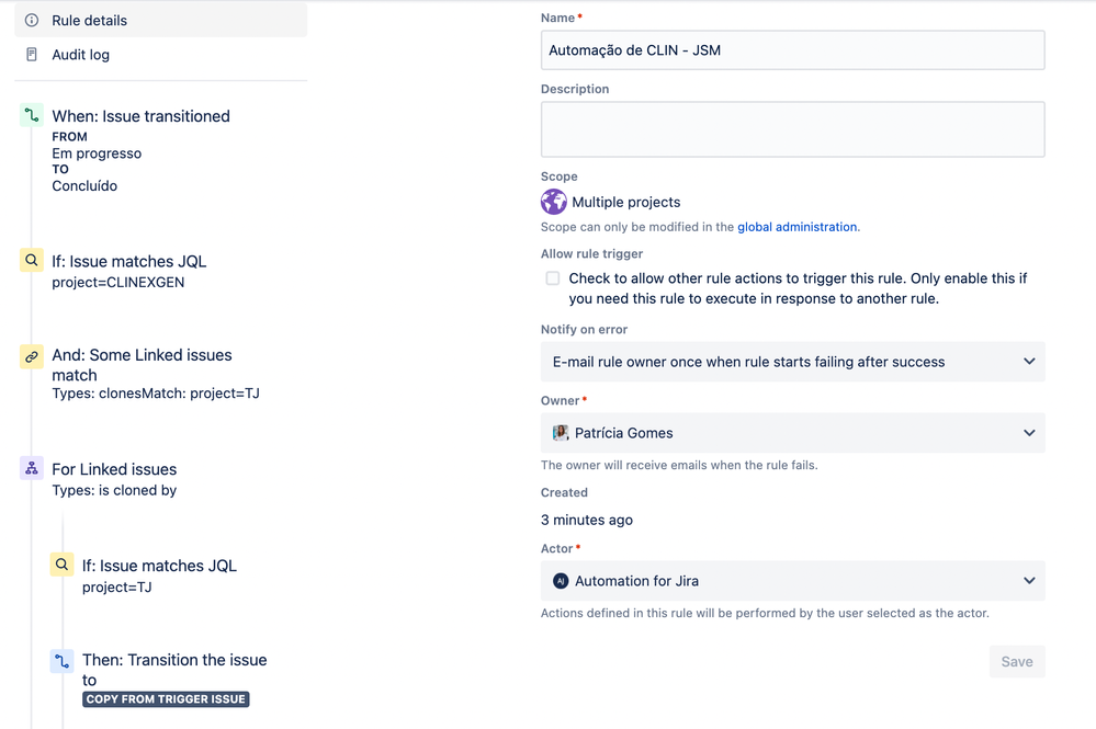

Patrícia Gomes March 11, 2022
Hi, @dwike.aprilia @Trudy Claspill @Pramodh M
I have the same problem, I replicated the rule you posted here, but dont work :(
my TJ clone doesn't change to "done" when CLINEXGEN ticket changes to "done"
Could you help me?
Tks

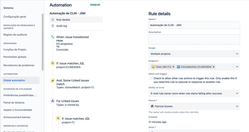

Trudy Claspill
March 11, 2022
@Patrícia Gomes
Is your Rule a global rule scoped to include both projects? Notice in your image under Scope it says Multiple Projects and that can be modified in the Global Automation. Can you confirm both the projects are specified there for the rule scope?
Can you confirm that you have changed an issue to Done in your source project, and the issue has an "is cloned by" link to an issue in the other project? What does the audit log for the rule say when such an event occurs?
@Trudy Claspill
Thank you for your answer!
Yes, I applied this rule to both projects,
I made recording of what I did so you can see better.
Create issue in TJ and Clone issue TJ to CLINEXTGEN: https://i.gyazo.com/1e0b0740d62d5193501ead11eb727f0d.mp4
Change status CLINEXTGEN to Concluido: https://i.gyazo.com/fe9e811debfe5171071e1154e21a565b.mp4 and  https://i.gyazo.com/6e069113528e62069c2f664be415f742.mp4
nothing change on TJ clone :(
Tks for your help

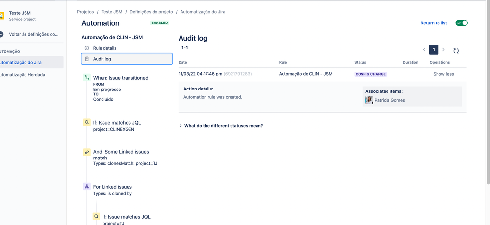

Trudy Claspill
March 11, 2022
Can you click on the Audit Log option in the rule and expand the log entry for the event where you changed the source issue?
Patrícia Gomes March 14, 2022
@Trudy Claspill
this?
doesn't seem to work. It did not log after running the action :(

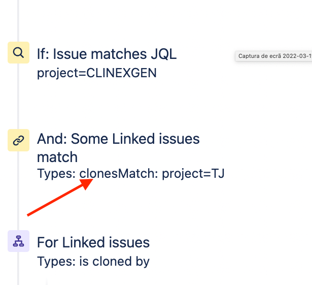

Trudy Claspill
March 14, 2022
I think your problem is here:
I think if you change that from "clones" to "is cloned by" then your Automation should work.
Like Patrícia Gomes likes this
Patrícia Gomes March 15, 2022
@Trudy Claspill
It is working!
Thanks for your help! :)
