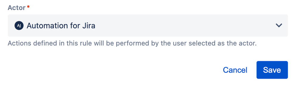

When creating a git branch I am moving a card from "SELECTED FOR DEV" to "IN PROGRESS" through an automation trigger. I would like to be able to limit that transition so that the only one who can move it is the actor of that trigger (the Jira bot). Jira defaults the actor of the trigger to be "Automation for Jira".

Automation Rule displaying the Actor (unchanged from default):Screen Shot 2021-02-12 at 4.04.47 PM.png

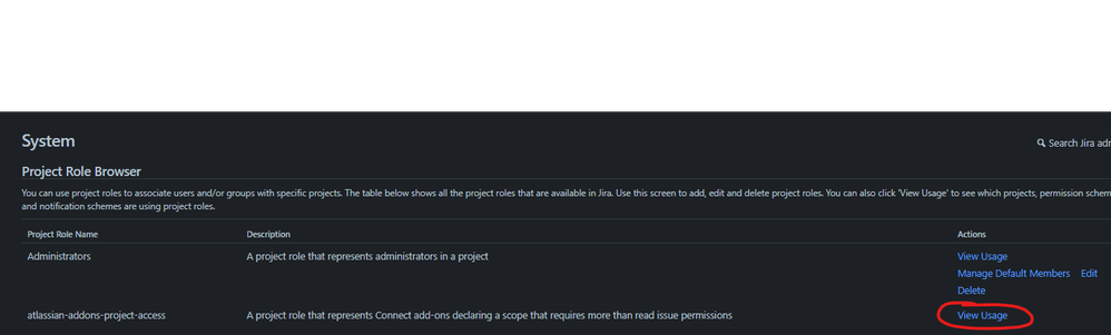

1) Find out what your automation id is:
    b) Click view usage for atlassian-addons-project-access
    c) the automation id is in the url

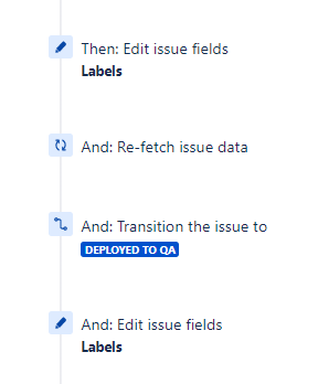

Hi! - I needed to do this as well, and figured out a workaround that may work on some situations. I can think of some scenarios where this may not solve your case.
In the workflow, the exclusive transition has a rule that allows the issue to transition only if it contains a certain label. In my case the label is "JiraAutomation".
Then, in automation, before using said transition, add the label to the issue, perform the transition, and then you can remove the label afterwards.
It is like marking the issue to enable the transition.
This works as a charm, because users won't see the transition in the list of available transitions, unless they manually add the enabling label. Just don't spread the word to the team.. haha!
Hope this helps someone!
Hugo Gómez June 7, 2022
Update with new discoveries...
1. After assigning the label to the issue to transition, you must re-fetch the issue's data (there is an action for that)  before performing the transition, this will ensure the label is properly applied before attempting the move.

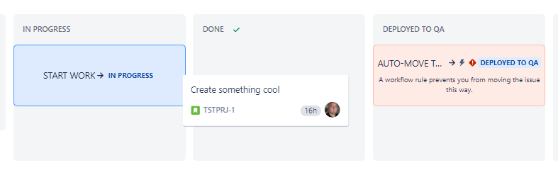

2. The experience on the Android mobile app (v93.1.1)  is not as good as on the browser app. In the browser the transition is highlighted as not available to user. (see drop zone on right)
jira-automation02.pngIn the mobile app, the transition IS allowed, then it is reversed after a few seconds. This indicates that the verification takes place after the move, and it is not prevented as in the browser app.
So far, that's about it.

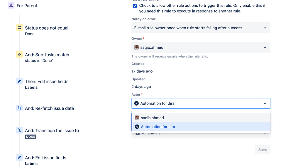

@Hugo Gómez Instead of doing this whole workaround, isn't it easier to just use the admin user (or your own user) as the automation rule's actor? Then in the workflow, only allow the automation rule's actor to make the said transition.
At any rate, the user who's configuring the label to be added and removed can do that manually as well. With him being the actor of the rule, only he'd be able to make the transition either manually or via the automation rule. The same effect would be achieved as previously without any loophole.
