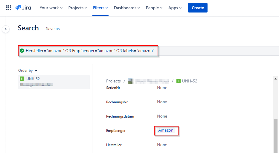

i got an practial idea, that I am using in my everday work. I am currently using three Labels fields (Hersteller, Empfaenger, labels)in my Jira Projects. To find any Issue, that is Containing the label i have set up a custom search in Microsoft Edge / Google Chrome.

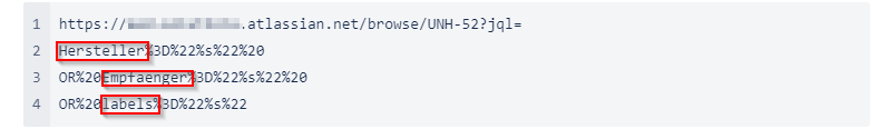

Use this URL and use your Labels fields
https://yourjiraadress.atlassian.net/browse/UNH-52?jql=
Hersteller%3D%22%s%22%20
OR%20Empfaenger%3D%22%s%22%20
OR%20labels%3D%22%s%22

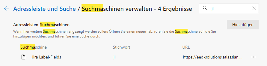

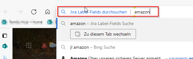

Finally, use it within the adress bar, open a new tab type in the stichwort "jl" (see screenshot above)) following with a space. Your Custom Jira Label-Fields Search engine will open and you can type in the label you are searching for (in this example "amazon").
Hit Enter. Now see all Jira issues with the Label "Amazon" in the Labels Fields Empfaenger / Hersteller or Labels.
