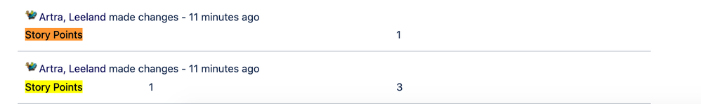

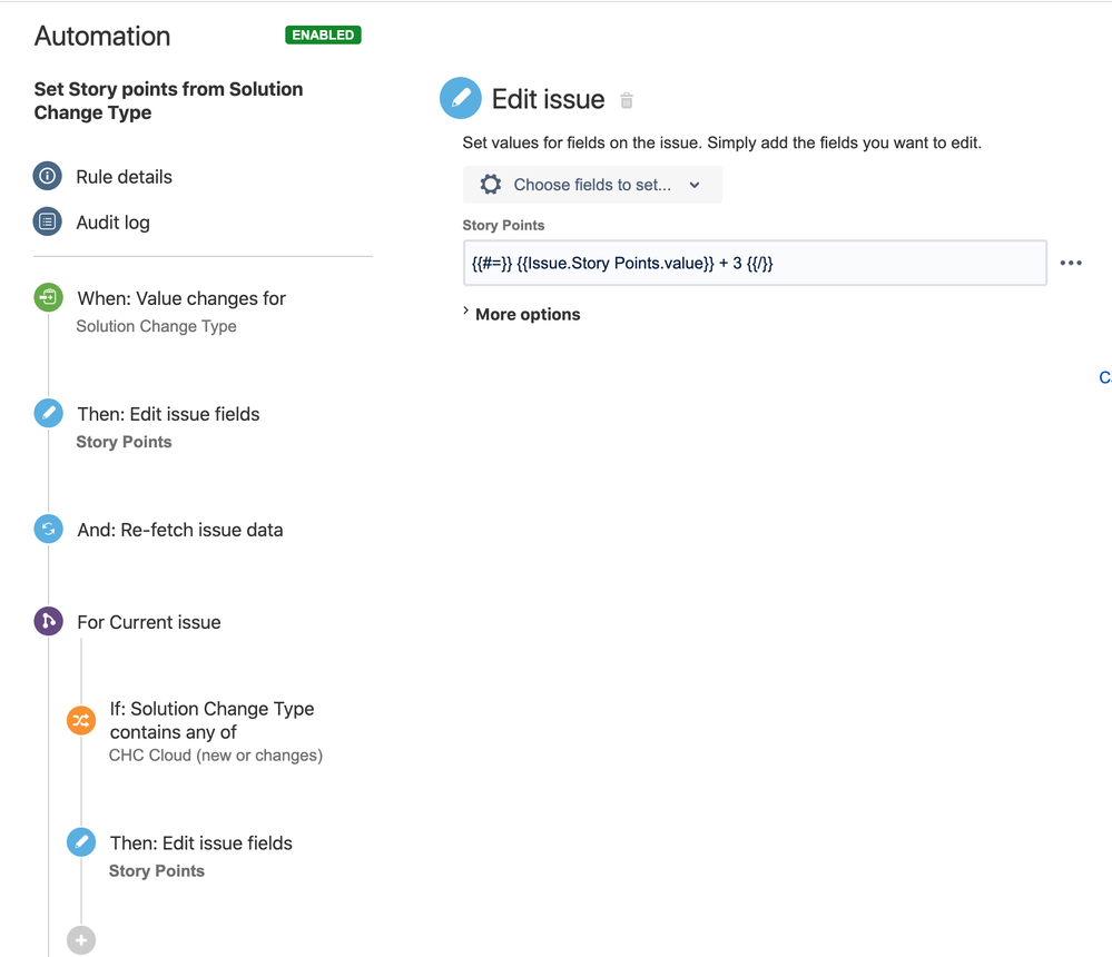

Thanks, that almost works. I built this:
But, Story Points is being set to 3 instead of the expected 4.
