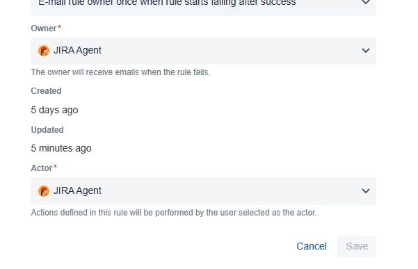

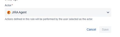

Is your field defined on the edit view? When it is not present a field cannot be edited by a rule.
Who is the rule actor (i.e. user) in the details section of the rule? Has this been changed from the default of "Automation for Jira"?
You seem to have covered all of the things I know which could cause this symptom.
At this point I recommend working with your Site Admin to submit a ticket to Atlassian Support for assistance. If you are using a paid license for Jira the admin can do that here: https://support.atlassian.com/contact/#/
