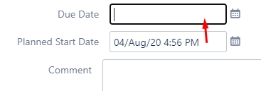

How to set another custom field date info in due date field?
This has a load of stuff about working with dates:
https://library.adaptavist.com/entity/set-the-value-of-date-or-date-time-fields
With due-date though, it is not a custom field, you can set it directly on the issue with issue.setDueDate(Timestamp) instead of finding a custom field.
