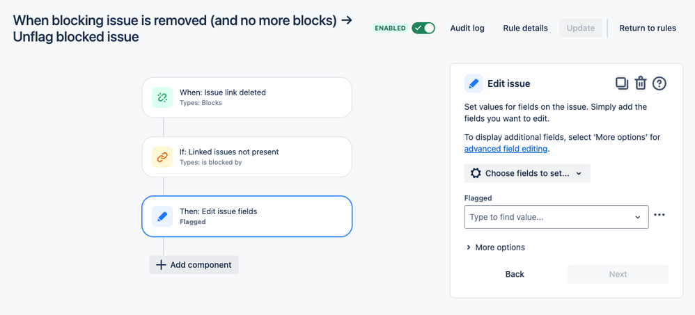

However the issue doesn't get unflagged when all blocking issue are unlinked. I tried this automation but it doesn't work for some reason.
Questions:
@Marc - Devoteam that did not work.
Interestingly I just checked the audit log and it marks the automation as working in my tests:
So I thought maybe the issue comes from the action, not the trigger. I added a simple label edit to the rule to validate this assumption, but still nothing happens :/

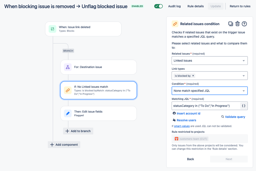

Ok progress! So by using the "destination issue", I can now unflag the blocked issue when removing a blocker (from either side).
The issue is indeed that this still unflag the blocked issue even when there are still other blockers on it...I would assume the condition "if linked issues not present" would catch that?

Well, apologies but I haven't reached a solution to my problem yet, as the unflagging should happen only when all blocking issues are removed. Currently it does it everytime.
I don't get why as the condition "if linked issues not present" (issues plural) is checked on the correct issue, aka the one where the action is correctly taken.
Ok I think I figured it out. This additional rule unflags the blocked issue, only when no other blocking issues are opened. Tested with multiple blocking issues, and while removing the blocking issue from either side.
Thanks again @Marc - Devoteam and @Bill Sheboy for your help with this!
