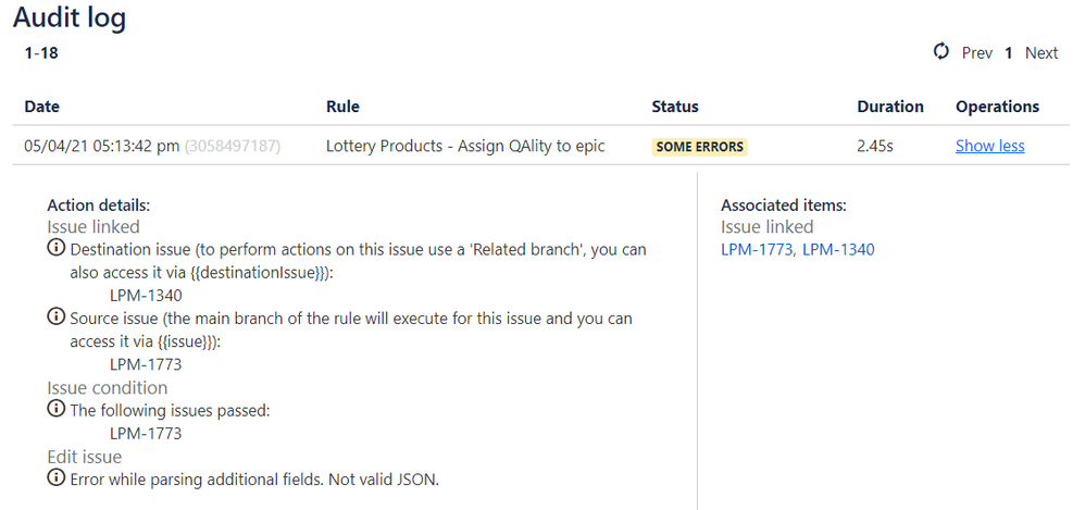

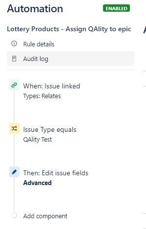

I have the following automation in nextgen project:
* When issue is linked, assign the new linked issue to the source issue parent (epic).
However, I keep getting "invalid JSON" error.
Any idea?

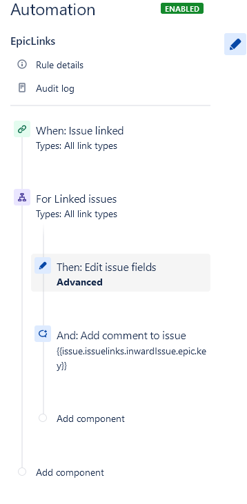

looking at your requirement I was able to reproduce an automation rule which worked fine in my demo next-gen project.
Setup: I have an Epic (ACC-4) as well as a story (ACC-2) linked to the Epic.
Now I have an additional story (ACC-3) that I link to previously created Story ACC-2.
=> The Epic link (to ACC-4) is added to ACC-3
In case I got you right here is the automation rule so you can double check:
The interesting part might be "Edit issues fields" where the following JSON made it work:
"fields": {
"parent": {"key":"{{issue.issuelinks.inwardIssue.epic.key}}"}
"Add comment to issue" however was just for testing purposes - I would not put that into production.
In case you'd like to check and let us know if this is what you were looking for I'd appreciate that.
Cheers,
Daniel

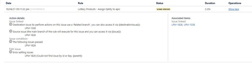

Hello @Daniel Ebers .
Still can't get it to work!
Note that I can't do the change on the branch as the item I am editing is on the main branch.
The setup I did it attached, so is the error I get ("Could not find issue by id or key. (parent)".65469879.jpg13246579.jpg132132132.jpg
Daniel Ebers
April 19, 2021
I am unsure if it works the way you setup the rule - probably this won't be the case.
Unfortunately, I cannot tell you anything beyond this but to confirm the rule I suggested worked in my setup.
Probably you will find other users contributing to fixing the rule you presented.

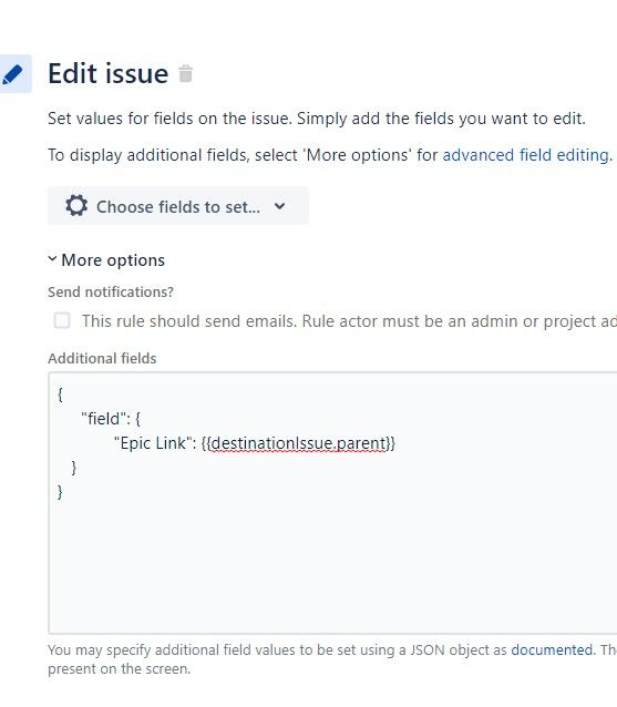

Hello @Eric
I need to update the field from advanced field editing.
This is how my JSON looks like.
Still I get an error of invalid JSON.
Any ideas?
