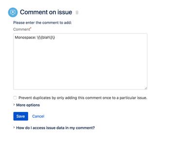

We would like to use monospace formatting in a Jira Automation Comment rule. Since the markup for monospace is double curly brackets - the same characters used for Smart Values - I havent figured out how to accomplish this.
Is this possible to accomplish?

It's a good question and the answer is yep you can definitely do this.
What you need to do is open the smart value with a backslash.
So, this would print out in monospace:
 \{\{monospace\}\}
Hope this helps!

I wanted to use the monospace formatting in a description while using automations. If I try {{monospaced}} there is no output and if I try \{\{monospaced\}\} the output is {{monospaced}} with the brackets.
What shoud I do to use monospace formatting in descriptions?

The accepted answer doesn't actually work in Automations... it just outputs "{{monospace text}}" as opposed to actually applying the monospace style to the text.
