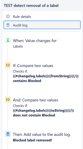

For your scenario, fieldChange is not detecting the label change.  Instead please try explicitly checking the field with {{changelog.labels}} such as with this:

Елена Елена
March 13, 2023
It seems to work

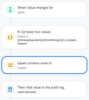

Bernhard Doleschel _Ease Solutions_
February 15, 2024
For me this process did not worked. Changed flow (step 3) works (I´ve tested for "Suspect" label):
