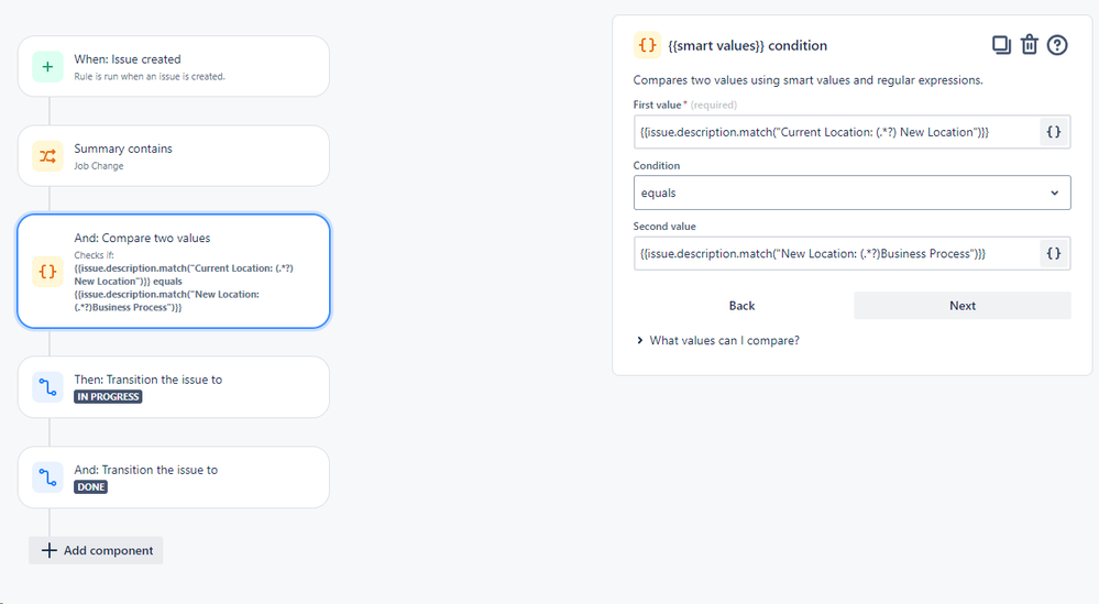

I want to automatically close any tickets where Current and New Locations are the same while keeping any open where they are not the same.
I thought I was close with the following:
I've taken care to perfectly match the spaces here (i.e. one space before "New Location"
When this rule is on it is closing every ticket that comes through (with "Job Change" in the title as per my first IF).
Can anyone tell me where I'm going wrong?

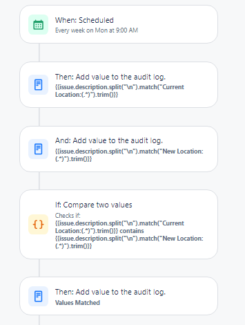

Hello @Taylor Dean
Please check @Bill Sheboy 's answer on how to do this here:
Basically you compare:
{{issue.description.split("\n").match("Current Location:(.*)").trim()}}
equals
{{issue.description.split("\n").match("New Location:(.*)").trim()}}
Hope it helps.
Thank you so much for your quick reply!
I'm very close. I think the last problem I'm running into is that there is a space after the value on "Current Location" but not on "New Location".
If that shouldn't matter with this value, then I'm not sure why it's not working.
Hmm. He is doing trim() on the extract...
Instead of doing "equals" check, do a "contains" check. Maybe thats what is throwing comparison off.
So, I just tested with the text you posted and contains did work.. Please share if issues.
