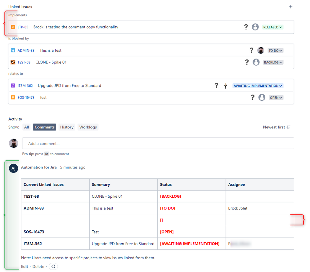

I have run into a problem that other users have reported where I need to give visibility to team members in one project that there is a linked issue in another project without granting them browse permissions in the second project.
What I want to do is summarized here: https://jira.atlassian.com/browse/JRACLOUD-60636
As a quick fix, I created a manual Automation rule allowing any user to request a printout of what issues are currently linked to their assigned issue.
The problem I'm experiencing is that our Jira Product Discovery project ideas are not printing. I'm wondering if I need to query them separately. Strangely enough, the rule produces a blank line where the linked issue from the team-managed project should appear.
Rule:
Result:
I thought the rule might be limited by being restricted to a single project but making it a global rule did not produce different results.
I tried to check the permission scheme for our JPD project, but they don't use normal permission schemes; everything is managed from the Access tab in the project itself. I will note that other automations do work with JPD projects, but Atlassian has admitted that Automation isn't fully baked for them.
