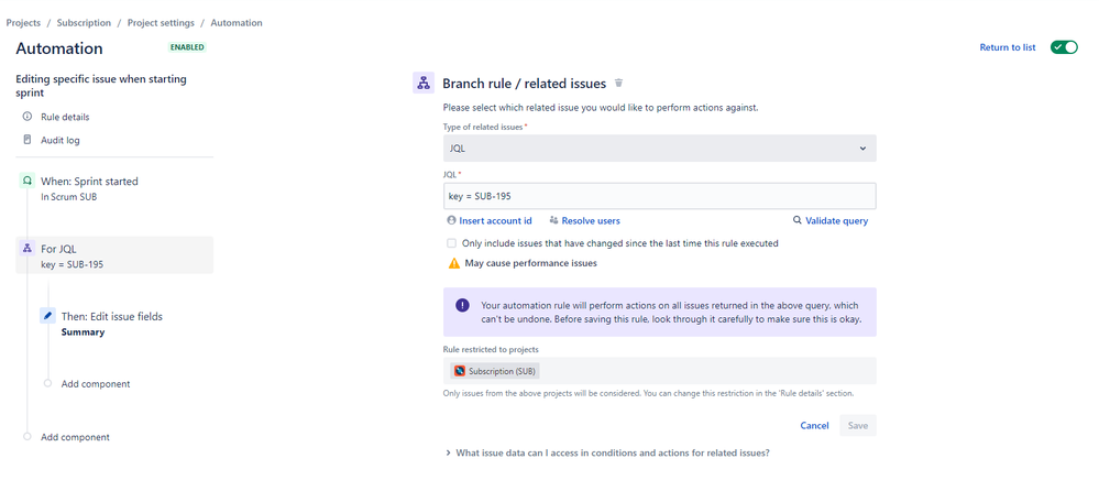

You need to make a rule as follows:
Trigger: Sprint Started > Insert the board where the sprint has been started
BRANCH > JQL
At the JQL branch use: key = your_issue_to_be_affected
Inside the branch add and Edit Issue action and insert the field to be edit. So when a sprint is started on the board that you defined in the trigger, this issue that you put in the branch will have the field edited. See the image about the automation rule:
Hope this helps :)

That worked! Thanks!
