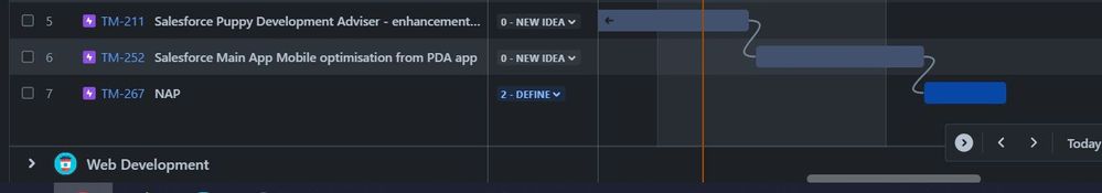

In the Timeline of a Plan is it possible for epic start and end dates to automatically move when the previous epic's end date is changed?
For example, in the screenshot below, the end date for epic TM-252 is 'Mon, Jul 15, 2024'. This epic blocks the next epic TM-267, which currently has a start date of 'Tue, Jul 16, 2024'.

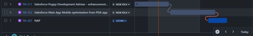

If I extend the end date of TM-252 to 'Mon, Jul 15, 2024', the dependency link changes to red to show that the two epics are now running concurrently (overlapping by 12 days) and not consecutively:
Is there a way to automate epic TM-267's start AND end date to move on 12 days so that the two epics are running consecutively again and no longer overlap?

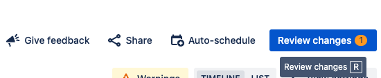

After dragging the bar to change the dates are you reviewing those changes and committing them to the underlying issues? The underlying issues won't be updated until you review and save the changes.
Yep, I discovered that straight after I'd posted!

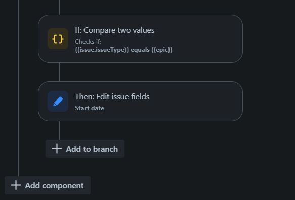

Having not done this before, I'm probably going completely the wrong way about it but this is what I've come up with so far but it doesn't work:
Using {{triggerissue.Due Date.plusBusiness Days(1)}} in the action
Am I anywhere close!?

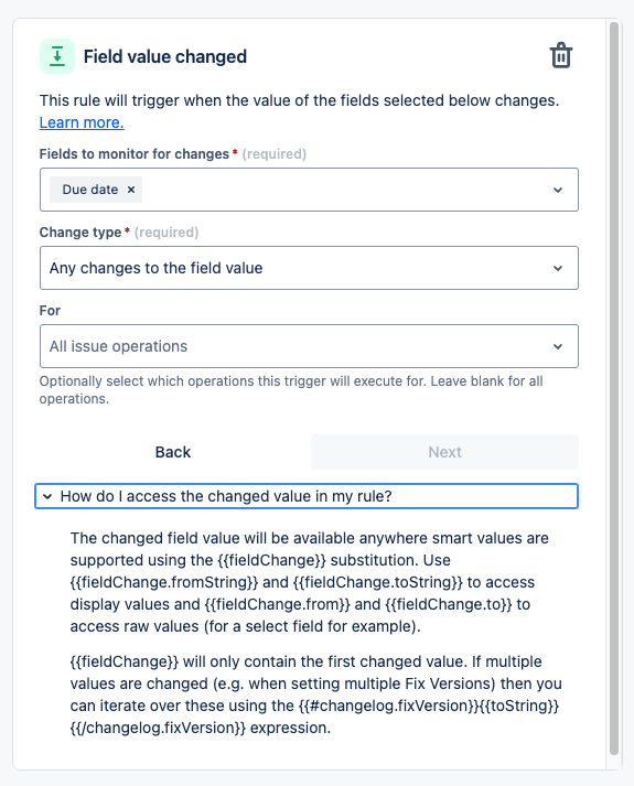

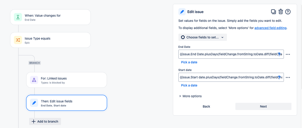

Let us first talk about the trigger for the rule. You selected "Issue Linked". That means the rule will be triggered when you create a generic issue link between two issues.
In your original post you said you want to update Epic dates when the dates for the "previous" Epic are changed. If that is the case, then the trigger needs to be "Field Value Changed" with the relevant end date field selected for monitoring. Then the rule would be triggered when the change to the end date is saved.

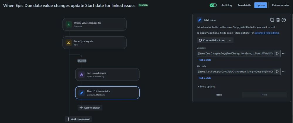

Next you would want a Condition to check that the trigger issue is an Epic type of issue. That will ensure that the rest of the rule runs only when the dates have been changed on an Epic.
The next step would be For Each: Related Issues: Linked Issue, where you would choose the Link Type you use to indicate the dependency between Epics.
Within the branch you would use the Edit Issue action to update the dependent Epic's dates.

When you use the Field Value Changed trigger it is possible to access the original and new values of the changed field.
But these values are accessible only as Strings. Since you are referencing a date field, you would need to use smart value functions to convert the String values to Date values so that you could then use the diff function to get the difference between the dates.
Converting the values is simple enough. You would use the toDate function:
original value: {{fieldChange.fromString.toDate}}
new value: {{fieldChange.toString.toDate}}

For that you would use the plusUnit() function, where Unit is the time of time period (hours, days, weeks). You would take the value you got above, providing that to the plusDays function, and applying the plusDays function to the field you want to change. In my example I used the End Date field.
{{issue.End Date.plusDays(fieldChange.fromString.toDate.diff(fieldChange.toString.toDate).days)}}
There are some refinements that could be made, but that is basically it.

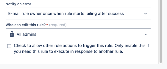

In addition, on the Rule Details page you would want to check the box that would allow the rule to be triggered by the actions of another rule.
The reason to check that box is because this rule will run and change the Epics directly dependent on the one you changed. But then you probably would want that change to continue to cascade down the chain to the Epics dependent on the ones the rule changed, right? You need to check that box so that the changes made to the first Epic(s) by this rule will cause the rule to be called again because of those changes, and make changes to the next dependent Epic(s) in the chain.

OK, so the specified fields are the start date and the due date and I have used these in the smart values - but it's still not working :(
{{issue.Due Date.plusDays(fieldChange.fromString.toDate.diff(fieldChange.toString.toDate).days)}}
{{issue.Start Date.plusDays(fieldChange.fromString.toDate.diff(fieldChange.toString.toDate).days)}}
What have I missed?
