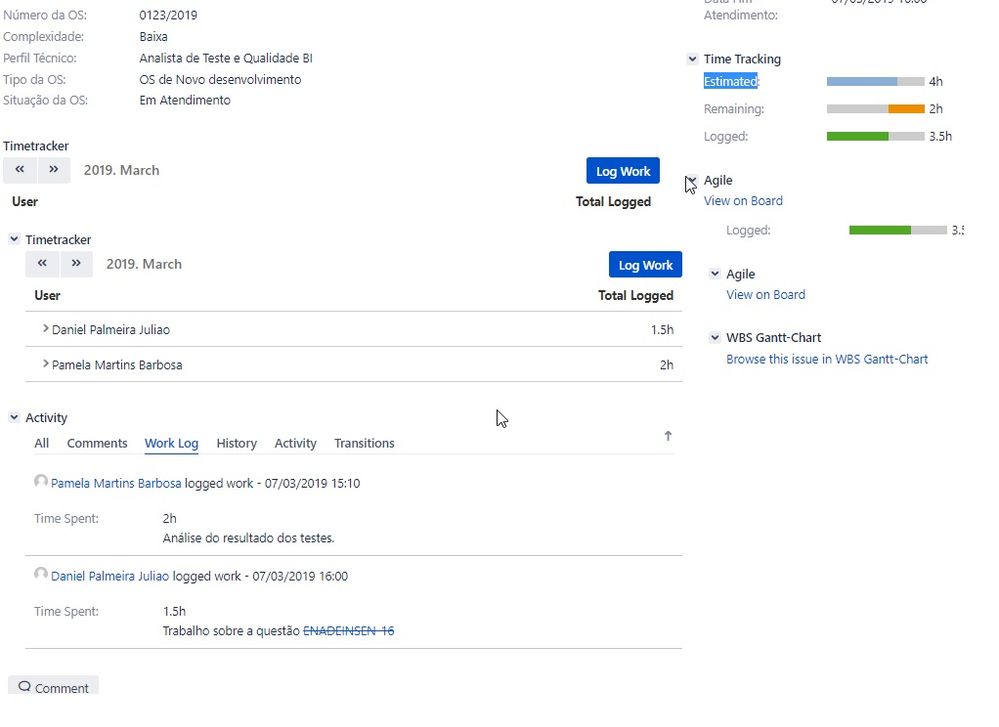

Cast_Informatica_S_A_ March 8, 2019
When adding multiple worklogs, the remaining generates a value above the estimated, even leaving the remaining blankprint work.jpg

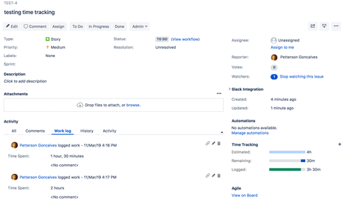

By default, if you don't set any values to the Remaining Estimate field it will automatically receive the exact same value configured for the Original time estimate (Estimated) field.
As you can see in the screenshot below, I was able to reproduce this behavior in my tests, using the same values you used:
That been said, the incoherent values that you are seen in your issue could only be caused by one of the following actions:

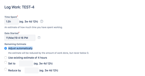

3 - In the worklog screen, one of the users marked a different option than Adjust automatically and added some extra time to the field Remaining Estimate (This action does not get logged anywhere)
