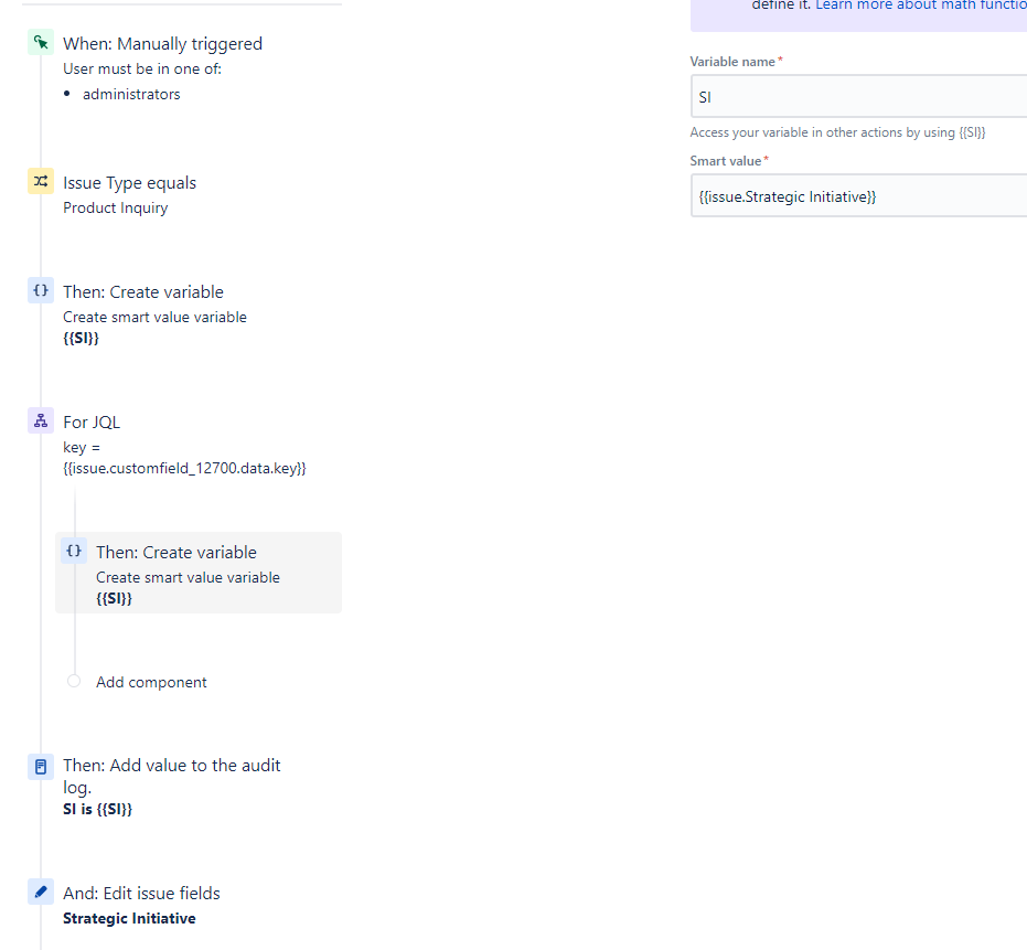

This is what I have
Strategic Initiative is a multi select field and the log output is a comma separated list. If there is just one value it edits the field on the trigger issue correctly.

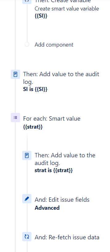

I tried branching over the variable {{SI}}

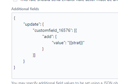

and then using this to update the field
but the error was
(Option value 'ABC, XYZ' is not valid (customfield_16576))
Is it possible to manipulate my variable {{SI}} (comma separated list) in such a way that Advanced Branching recognises it as a list that can be branched over?
