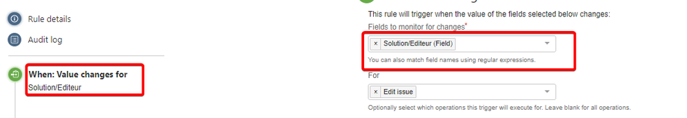

But our use case is that when the issue is created or updated and that field Solution/Editor is changed, we need to execute an automation rule
When using the Field value changed trigger, we are not able to trig the rule to detect the change from None to a list value.
What is the way to detect that initial change from None to a selected value of that list ?

When an issue is created the Issue Created trigger is the one to use normally. I note the Field Value Changed triggers is documented to also work for create issue for Server/Data Center version, but you appear to only have selected Edit Issue. Perhaps try adding the create options also.
Next, are you observing the rule not triggering for issue updates? Have you tried the generic Issue Update trigger and examined {{fieldChange}} is see if the change is noticed at all for that field?

It works by adding the Create Issue
