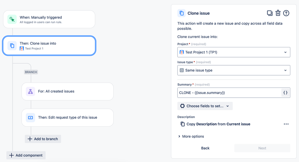

Nadhila Savira
July 5, 2024
Hi James,
There's actually a Clone issue action in Automation.Screenshot 2024-07-05 at 09.11.49.png
And, there's also a Move issue to board action too that is specific for Software projects. Try playing around with Automation, it might help you with your requirements here
