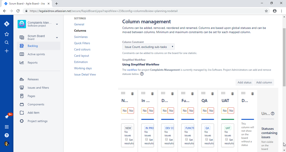

Mate, can you provide a screenshot of the column configuration of the scrum board. I am fairly certain that there are unmapped statuses in the column configuration .
Is it? Can you please help me out if that is the case? Following is the screenshot:
I see two issues in the screenshot
Did someone try to play around with the workflow and then didn't map the status from old workflow to new?
I tried to assign the status to the issues but they are still not showing up in the sprint board. From the filter also I am getting all the issues.
I am getting only grey, blue and green coloured columns.
