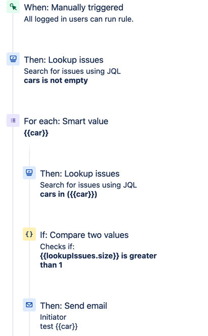

I was able to get something to work!
The general configuration looks like this:

I'm doing something wrong. To be honest, I'm not sure what cars refers to in your example.
In any case, below is a snapshot of what I wrote

No, that won't do anything. Can you share a screenshot of the branching you are trying to do?
