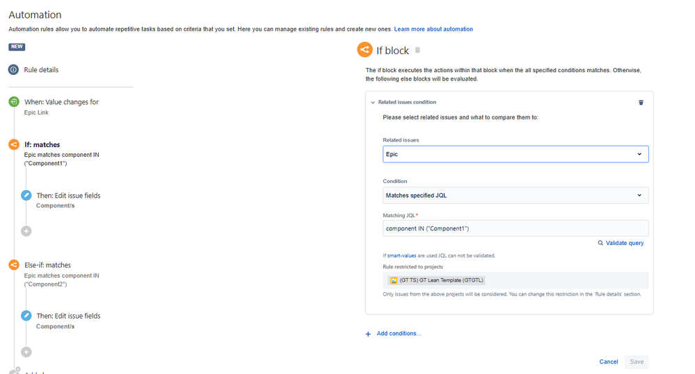

When you want to selectively add one or the other Component, please use an if / else block in your rule to make that decision with conditions.

You could try something like this:
Let me know if it works for your scenario.

have you already tried setting a related issue condition based on Epic?
Then you should set the specific Edit issue action via JSON as already suggested in other comments.
