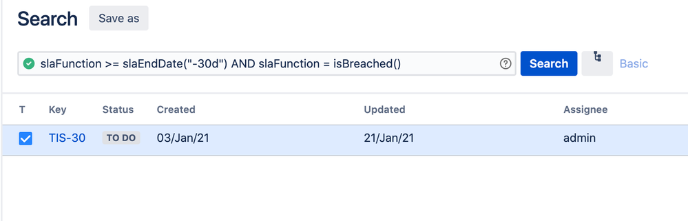

You can perform the search with slaFunction = isBreached() and order the results by SLA end date with order by clause.
project = TIS and slaFunction = isBreached() ORDER BY slaEndDate
Or TTS search functions like this: slaFunction >= slaEndDate("-30d") AND slaFunction = isBreached() (You can pass SLA ids and names as parameters)

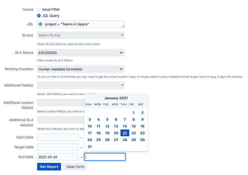

You can use the reporting functions to extract the SLAs that have ended this month and has the breached status like below.
You can also save the report configuration for later use.

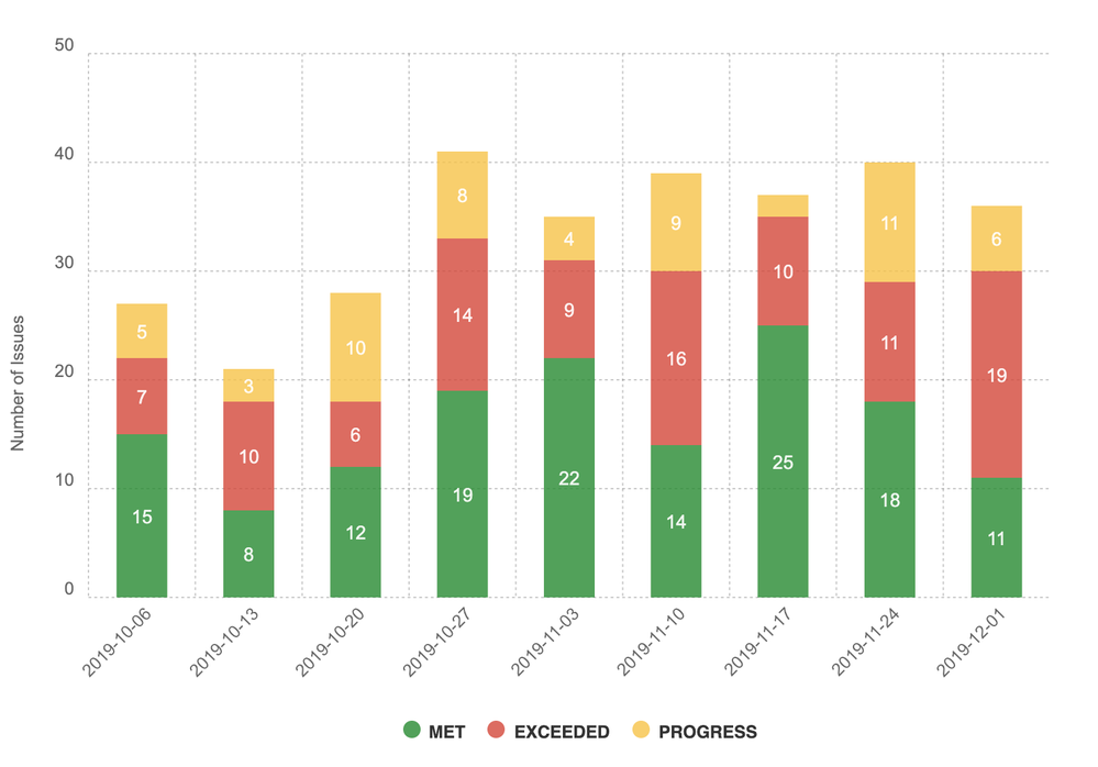

Or you can use the TTS gadgets to investigate the trends. The best part is - these gadget are interactive, when you click on them, it'll take you to the issue navigator and show you the related issues.

Hey @Gökçe Gürsel {Appfire} .
Is it possible to get a report exported to a table to show how many breach of SLA there was per week the last 4 weeks for example? And have different filters for each row in the table?
