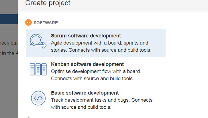

I am getting project type key and I am able to filter to Software level . But we want to filter further. In jira when creating software it gives 3 options scrum/kanban and basic software. So using the API to fetch projects I want to know if the project is scrum or kanban or basic software.
chakravarthi pottem May 9, 2017
Capture.PNG Please see image
