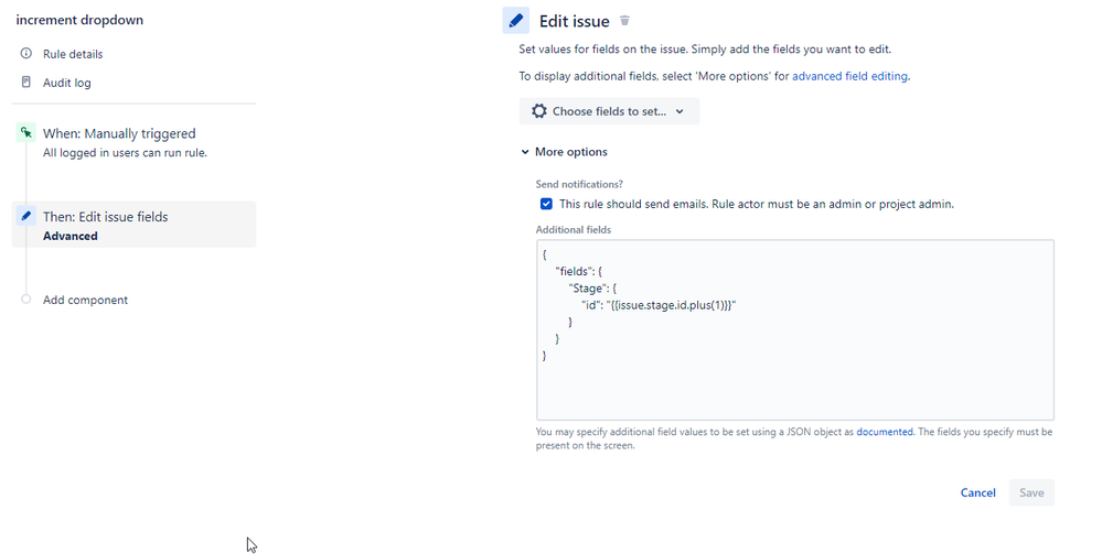

In my case I just tested the increment and the setting via ID (without the trigger and a newly created issue therefore the hint to use the smart vale triggerIssue).
My rule looks as follows:
Hope this was helpful.
