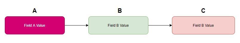

Diagram1.JPGWhat I don't want to happen is when A is updated to send the value to B. I need it the other way around.
  • When B is updated, I want it to take the value from A.
  • Same for C, I want it to take the value from B and not when B updates to send the value to C
So if C is added to the end of the chain and B has not yet updated to take the value from A, then C also will also not get the value as it's not present in B.
I can easily get A to send the value to B when A is updated. But I don't want to update A to pass the value to B, because this would be sending the value down the chain. I need the lower items to take the value from above if possible.
Thanks!
