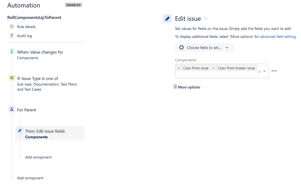

Hi John,
This is what I have so far and it works for adding a component to the list on a sub-task. What I haven't figured out yet is if I remove a component from a sub-task how to remove if from the parent only if it is not included in the component list of any other sub-task of the same parent.

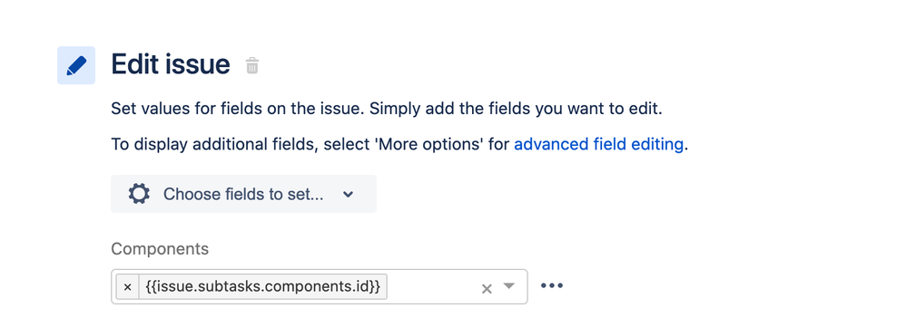

If i do a smart value of issue.subtasks.components.id then i get all the ids for all the sub tasks. BUT, see the bolding? They're both lists. And they're nested so you end up getting a list of lists: [ [a, b], [c, d] ]. And we can't work with that easily. Eg, this does not work:
The reason being that it just expects a list of values. Not a list of lists.

and my rule:
