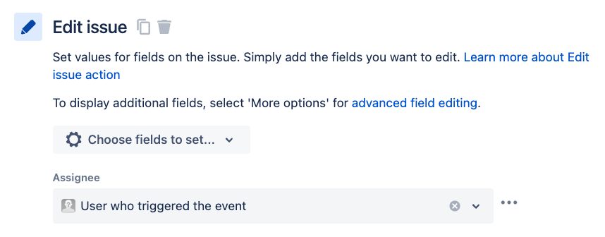

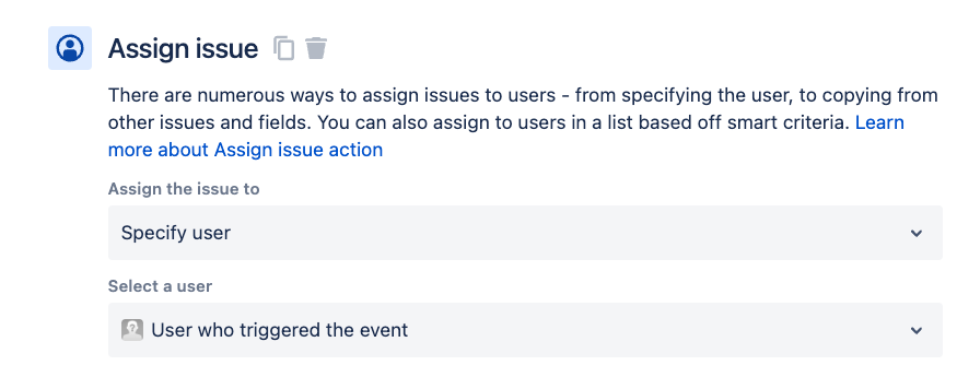

I am trying to create an automation that assigns a user to an issue when a Pull Request is created, however, all the ways I tried so far leaves the user as Unassigned even though in the audit log, it shows that the automation was successful.
What's strange is that if I change the trigger to be Manual, then the assignment works. I've listed so far the various ways to assign the user below.
Option 1: Using the Assign User action [set it as User who triggered the event]
Option 2: Using the Edit Issue action [set it as User who triggered the event]

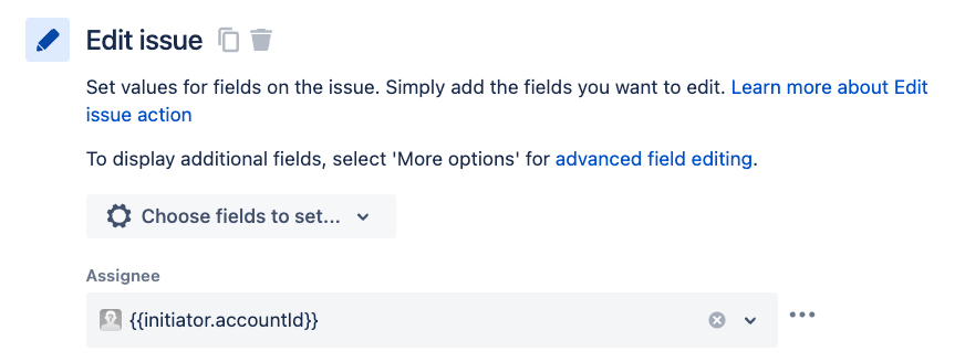

Option 3: Same as Option 2, but [set it as {{ initiator.accountID }}]
The audit log reports that the issue was edited successfully. Screenshot below is one where I had both the Assign issue and Edit issue actions enabled. Can see that the log shows it was ran without issue, but looking at the history within the ticket, no changes were made

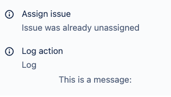

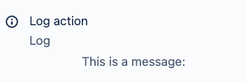

Using the log action, it doesnt return a value. In the action, my input is: This is a message: {{initiator.accountId}}. You can see the output doesn't return the expected account
